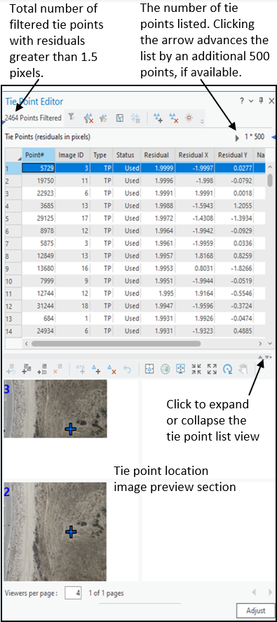

    The Tie Point Editor window appears, listing tie points with a residual greater than 1.5 pixels and sorted in descending order.
  2. Select a tie point of interest from the list to automatically populate the preview section with the associated images that contain the tie points.
    In the Preview section, the Image ID attribute associated with the selected tie point is displayed at the top of the window.

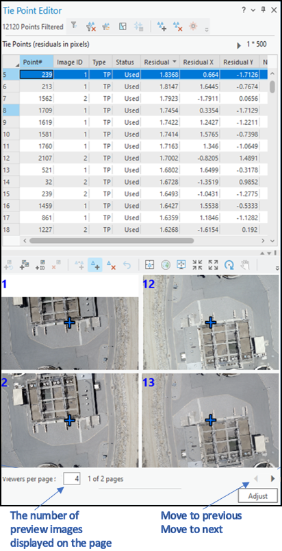

      In the expanded preview window, the images are more interpretable. The list view is also expanded.
    To view only the preview images, click the Expand button above the preview window toolbar on the right.
  3. To reposition a tie point, click the Add tie point button , and click the new location in each image in the preview window.
