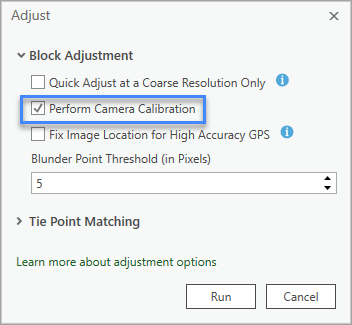

Camera Calibration table
This table lists the camera calibration information for the adjustment. This information is either provided with the cameras tables when configuring the ortho mapping workspace or calculated when you check Perform Camera Calibration on the Adjust dialog box.
Perform Camera Calibration option on the Adjust dialog box
The table is only listed in the report for aerial and drone imagery. The fields in the Camera Calibration table are described as follows:
