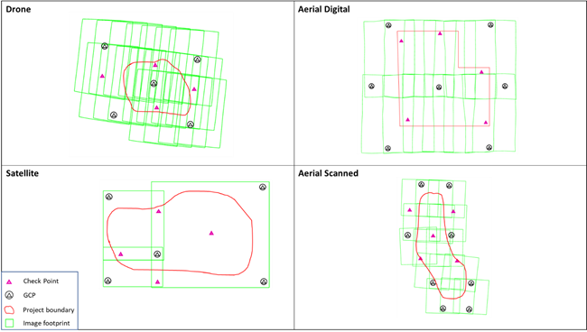

GCP distribution
The distribution of GCPs in a photogrammetric block is an important part of the accuracy of the adjusted block. Control points distributed around the perimeter of the block have a greater influence on adjustment accuracy than control near the center of the block. The figure below shows recommended GCP locations prior to block adjustment.
Recommended GCP distribution

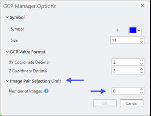

  8. If the dataset being processed has a high number of images — greater than 15 — overlapping each GCP, it is recommended that you set an Image Pair Selection (IPS) limit to enhance performance. The IPS limit defines the number of images to be used during GCP image correlation. If the IPS limit is 0, all images will be used to support image correlation during semi-automated GCP collection. If the IPS limit is greater than 0, a system-defined criteria will be used to select optimum images to satisfy the defined IPS value. For example, if 100 images overlap the GCP and an IPS limit of 10 is defined, an attempt will be made to identify the GCP in 10 images.
    Image Pair Selection Limit
    To set an IPS limit, do the following:
    1. Click the GCP Manager Options button .
    2. In the Image Pair Selection Limit section, define an IPS value, then click Enter on the keyboard.
    3. Click OK to accept the changes and close the GCP Manager Options window.

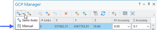

  9. In the GCP Manager window, click the Semi-Auto button to use the semi-automated tool to tag GCPs, or click the Manual button from the drop-down list to tag them manually.
    Add Semi-Auto or Manual GCP
    Note:
    To use the Semi-Auto option, click the GCP in the first image in the Preview section of the GCP Manager window, and the GCP will be automatically identified and tagged in all the overlapping images listed. When using the Manual GCP collection option, you must manually identify and tag the GCP in the overlapping images.

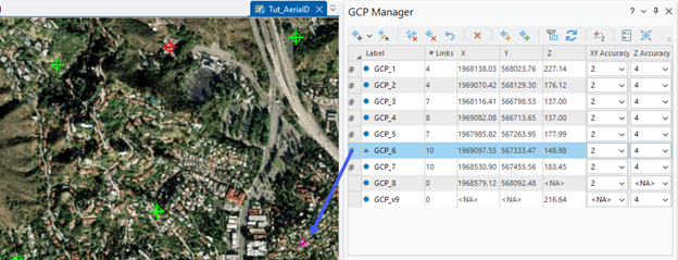

Change GCPs to check points

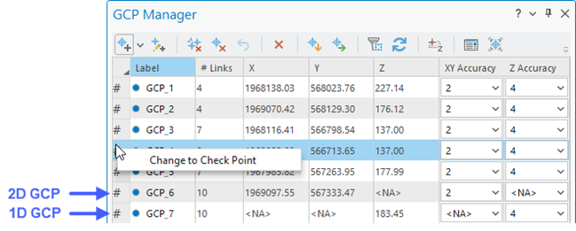

You can change GCPs to check points for accuracy assessment. Check points are conceptually the same as GCPs; they are points with known ground coordinates and link to features visible in multiple overlapping images. However, they are not used as inputs to control the adjustment process. Instead, check points measure the accuracy of the adjustment and the resulting orthoimage. For each check point, the distance between its known ground location and the location of the corresponding pixel after the adjustment process is used to calculate the overall absolute accuracy of the block of images. Accuracy measurements are summarized as the root mean square error (RMSE) using the check points and are available in the Adjustment Report window.
To change GCPs to check points for postprocessing accuracy assessment, complete the following steps:
  1. After the GCPs have been added and tagged with tie points in the ortho mapping workspace, select the GCP to change to a check point in the GCP Manager window.
  2. Right-click the GCP and click Change to Check Point.
Change a GCP to a check point.
The check points are displayed as pink triangles in the ortho mapping workspace map, and the label icon in the GCP Manager window changes from a blue circle to a blue triangle. To change multiple GCPs to check points, select GCPs by pressing the Ctrl key while clicking each GCP in the list. Right-click the group-selected points to change the GCP type.
Once you tag GCPs or tie points, you must click Adjust to rerun the block adjustment and use these points.
Check points in the GCP Manager window
