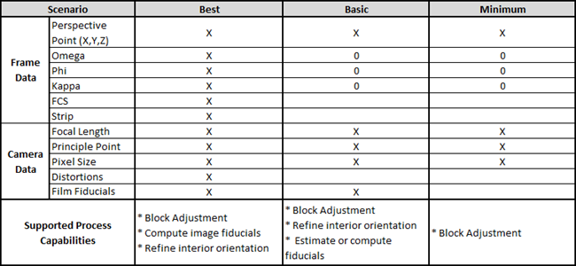

The type and quality of your metadata will determine characteristics of your ortho mapping workspace and the quality of your ortho mapping products. For example, if you do not provide fiducial information, you cannot refine the interior orientation. You can estimate fiducial information to produce a fiducial template used to refine your interior orientation and produce improved ortho mapping products. The processing capabilities supported by different levels of metadata information are summarized in the table below.
Types of adjustments supported by different levels of metadata information.
Note:
  • Omega, Phi, and Kappa are required, but if these values are missing, you can enter a value of 0 (zero) in your frames table, and they will be estimated automatically.
  • The film fiducial information can be estimated from the camera's film coordinates if a formal calibration report is not available.
