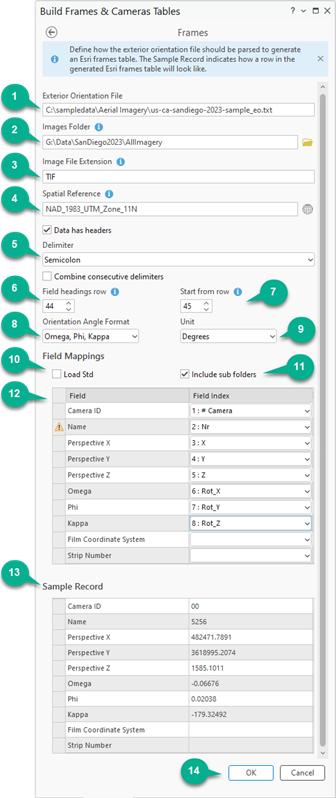

Follow the steps below to create the Esri frames table. Click the Build Frames & Cameras Tables tool you added to ArcGIS Pro to open the tool.
  1. Enter your Exterior Orientation File.
    Supported formats are .txt, .csv, .tab, and .eo files. Parameters will appear so you can define how your exterior orientation file should be parsed to convert it to an Esri frames table. The following information is required in the exterior orientation file: Image Name, Perspective X, Perspective Y, Perspective Z, Omega, Phi, Kappa. See Frames table schema for more information. The field names in your file do not have to match the field names listed in the Frames table schema, since you will be mapping your fields in the steps below. If your data has headers, check the Data has headers check box in the pane if not already checked.
  2. Browse to and select your aerial digital or scanned imagery folder.
  3. Type the image format extension of your images. For example, type TIF, JPG, MRF, and so on.
  4. Specify the spatial reference of your perspective points.
  5. Select the delimiter that will be used to parse your Exterior Orientation File. You can combine consecutive delimiters if necessary.
  6. For Field headings row, enter the row number that identifies where the exterior orientation field headings start.
    If you want to skip a number of images, specify the row number from which to begin parsing the file.
  7. For Start from row, enter the row number that identifies the beginning of the exterior orientation information.
  8. Select the appropriate Orientation Angle Format from the drop-down list.
    • Omega, Phi, Kappa (default)
    • Phi, Omega, Kappa
    • Roll, Pitch, Yaw (Fixed Wing)
    • Roll, Pitch, Yaw (Rotary)
  9. Select the Unit associated with the selected Orientation Angle Format from the drop-down list.
  10. Optionally, check the box next to Load Std (standard deviation) if the exterior orientation file contains this type of information.
    When selected, the following fields will be added to the Field Mappings table:
    • Std X—Standard deviation for the perspective X, or easting coordinate.
    • Std Y—Standard deviation for the perspective Y, or northing coordinate.
    • Std Z—Standard deviation for the perspective Z, or height coordinate.
    • Std Omega—Standard deviation for the omega angle.
    • Std Phi—Standard deviation for the phi angle.
    • Std Kappa—Standard deviation for the kappa angle.
  11. Imagery stored in subfolders will be processed when the Include sub folders check box is checked.
  12. Define your field mappings as described in the Frames table schema.
    Note:

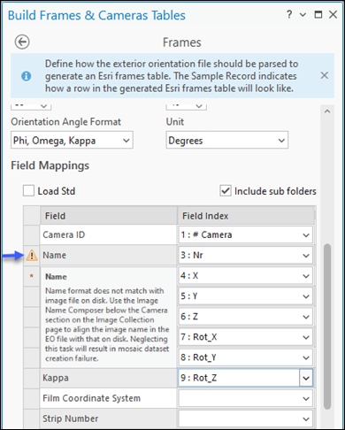

    The Name field is required in this tool, though it is an optional field in the frames table itself. This is because the Name field is combined with the Images Folder and Image Format to identify the full path to each image in your collection. Because of this, the Name field must point to a column in your exterior orientation file with image names that are associated with or match the exact names of the images in the Images Folder.
    For scenarios in which the image name in the exterior orientation file does not match that on disk, a warning flag will appear to the left of Name in the Field Mappings section. Once you have completed defining the parameters in the Frames window, the Image Name Composer will become accessible (after entering or importing camera calibration information) on the Source Data page, that can be used to link the name in the exterior orientation file with that on disk. See the Image Name Composer section below for additional information.
  13. Review the Sample Record for accuracy and completeness.
  14. Click OK to accept the settings for the Build Frames & Cameras Tables window.

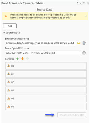

    The Source Data window appears.
    Source Data window

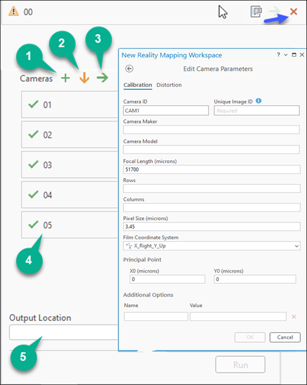

Once you have completed defining the parameters in the Frames window, if the ingested exterior orientation file has multicamera IDs, they will be listed in the Cameras section of the Source Data page. It is recommended that you delete cameras not required for your project before entering camera calibration information. This can be done by hovering over the camera of interest and selecting the delete option on the right.
Delete Camera

  1. Manually enter individual camera information by selecting the Add tool . You will be prompted to provide information on the Calibration, Distortion, and Fiducial tabs. The following information on the Calibration tab is required: Camera ID, Focal Length, Pixel Size, and Principal Point; all other parameters are optional. For detailed information on the parameters and information that can be input in the camera model, see Cameras table schema.
  2. Alternatively, select the Import tool to browse to an existing .txt or .csv file containing the cameras information with the fields described in the Cameras table schema.
  3. Once you have completed manually entering the cameras information, the Export tool can be used to save a copy of the file for future use.
  4. The cameras will be listed according to their CameraID. A green check mark next to the CameraID indicates that the required information has been provided. A caution symbol indicates there are incorrect or missing fields.
  5. Browse to and select an output folder location, then click Run.
    The Esri cameras and frames tables are created in the output folder location.

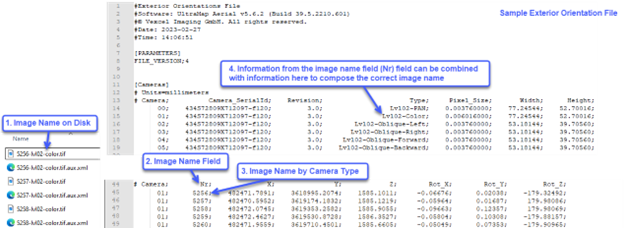

Image Name Composer
In scenarios in which the image name in the exterior orientation file does not match that on disk, the Image Name Composer enables the formulation of matching image names to support the creation of a Frames table. Matching image names can be formulated using information in the image name field and other sections of the exterior orientation file.
Image Name Composer
For example, using the exterior orientation file below, you can see that the image in the name field (Nr) is different from that of the image name on disk for one nadir imagery (5256-lvl02-color.tif). Using the Image Name Composer, a proper image name can be formulated by combining the information in the Nr field with the information in the Camera 01 Type field (Lvl02-Color), resulting in a composed name of 5256-Lvl02-Color.
Exterior orientation file example

  • The image name in the exterior orientation file ingested in the Frames tool is different from the image name on disk. In this scenario, a warning flag will appear next to the Name field in the Field Mappings section of the Frames page.
    Build frames warning

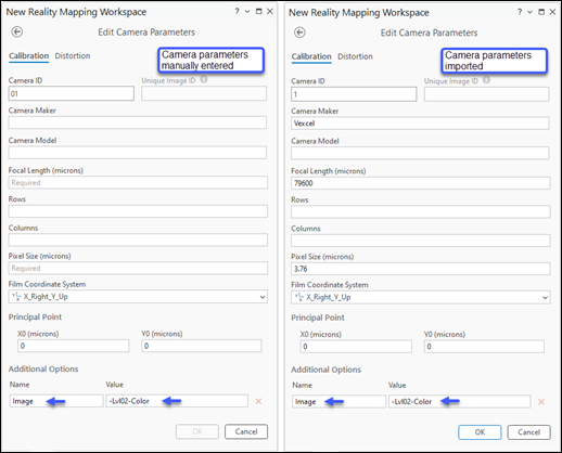

  • Information to compose the image name is manually entered or imported, for each camera, into the Additional Options section of the Add New Camera window, or Edit Camera Parameters window.
    Import or manually input camera parameters.
  • If the above conditions are not satisfied, the Image Name Composer option will not be enabled. In scenarios in which there are no discrepancies between the image name on disk and image name in the exterior orientation file, the Image Name Composer option will not be enabled in the Source Data window.
To use the Image Name Composer to formulate the correct image name for use in the Frames table, follow the steps below.
Note:
The following instructions assume that all the parameters required for the frames table have already been defined in the Frames window.
  1. On the Source Data page, in the Cameras section, click the Add New Camera button to manually enter camera parameters for each camera. Alternatively, click Import to import the parameters from an existing camera file on disk.
  2. In the Additional Options section, for each camera, enter appropriate values for the Name field and Value field, then click OK to accept the changes. For example, using the information in the sample exterior orientation file depicted above, the following information could be entered into the Name and Value fields for each camera.
    Image name table

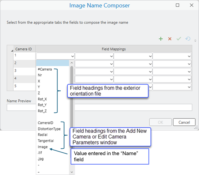

  3. Once the parameters for each camera have been entered, the Image Name Composer button will become active. Click it to open the Image Name Composer window. The menu options available in the window include Add a column, Delete the last column, Apply selected record format to all rows, and Reset selected record.

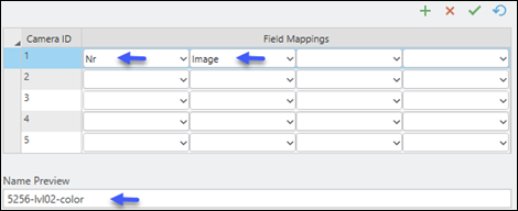

  4. For Camera ID 1, click the drop-down menu in the leftmost box, and select Nr.
  5. Click in the box to the right of the previously selected box, and select Image from the drop-down list. The associated image name is displayed in the Name Preview section.
    Name preview
  6. With camera ID 1 selected, click the Apply Format button , then click Yes to confirm the formatting.
    The values for camera ID 1 are copied to all remaining cameras.
  7. Click each camera ID and verify the accuracy of the associated image name in the Name Preview section.
  8. Click OK to accept the inputs, and close the Image Name Composer window.
