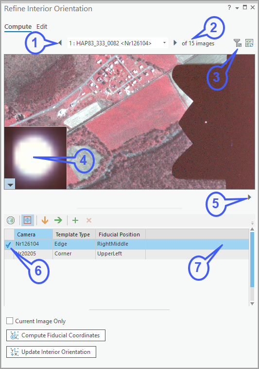

Compute tab
The following graphic and table summarize the functionality of the Compute tab in the Refine Interior Orientation pane:
Functionality of the Compute tab in the Refine Interior Orientation pane
Indicator
Description
The name in the text box reflects the image name prefixed with the corresponding ObjectID from the footprint table. Click the arrow to display the next image, or choose an image from the drop-down list.
The total number of images defined by the filter, camera selection, or map selection.
Use the Filter Images button to filter images that do not have resolved fiducials or are resolved with only three match points.
The pop-up window displays a picture of the current template.
5
Click the arrow to pan to the next fiducial position in the current image and display scale.
6
A blue check mark indicates that the picture in the pop-up is defined for the current template.
7
Select a specific row to display in the template and pop-up picture for the corresponding fiducial position.

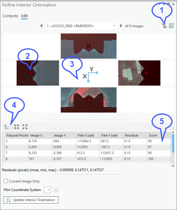

Edit tab
The following graphic and table summarize the functionality of the Edit tab in the Refine Interior Orientation pane:
Functionality of the Edit tab in the Refine Interior Orientation pane.
Indicator
Description
A red X indicates the position of the fiducial point that is being edited.
The FCS of the current image.
Use the Edit tool to add or edit a fiducial point. Click the Edit tool, and click the center of the corresponding fiducial in the preview window.
5
Select a row to edit or view a specific fiducial point.

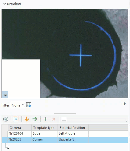

  2. Define the fiducial templates by capturing a picture of a fiducial for the existing templates, adding a template to the templates table, or importing a predefined fiducial templates table.
Capture fiducial pictures
Complete the following steps to capture fiducial pictures:
  1. Click the template in the fiducial template table for which you want to capture a picture.
    1. Optionally, use the next button to display the next fiducial of the same fiducial type in the current image.
    2. Press Ctrl + C and move the pointer to zoom or pan the image if necessary.
    The image display in the preview window uses a default renderer defined in Option > Image and Raster > Appearance, and you can redefine it if necessary.
  2. Click the Capture Fiducial button to draw a circle around the fiducial by clicking the center and dragging the pointer outward.
    To change the picture of a template, recapture it.
    To clear the template picture, right-click the template and choose Clear Template from the context menu.
The captured picture is automatically written to the fiducial template table in the ortho mapping workspace.

Edit fiducial image coordinates
You can review and edit fiducial points using the Edit tab when fiducial calculation fails for an image. In the fiducial point table, values in the Image X and Image Y fields are calculated image fiducials, and values in the Film X and Film Y fields are the film fiducial coordinates of the camera, which are provided during the creation of a workspace. The Score field describes the similarity of pixel values in the template to those at the other fiducial positions in the image. The Score value range is 0–100, where 100 indicates a perfect match. The Residual field is the transformation error at that fiducial position.
Use the Unresolved filter to identify images where fiducial matching failed and no image fiducial points were detected. Use the Resolved with only 3 match points filter to find images that need to be reviewed and edited.
  1. Select a fiducial point row in the table and examine the corresponding values in the table.
  2. Check the preview.
    The corresponding fiducial marker should fall on top of the fiducial center.
  3. Press Ctrl + C to pan or zoom.
Manually edit fiducial points
Complete the following steps to manually edit fiducial pictures:
  1. Click the Edit button to activate fiducial editing. Click the center of the fiducial mark in the preview window.
    The image coordinates for this position are updated in the table.
  2. Select another row in the table and repeat the same steps to measure other fiducials.
    You can also review and redefine templates, and recompute the selected images.
