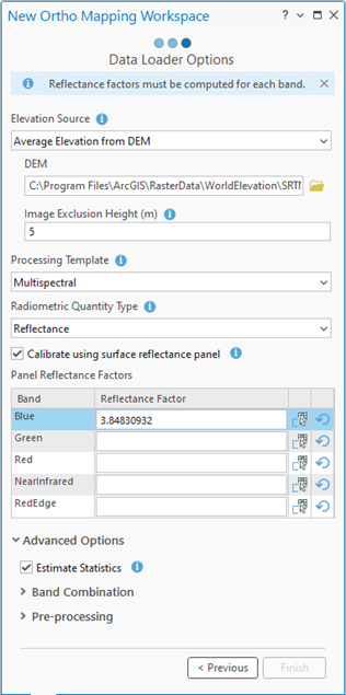

  14. On the Data Loader Options tab, you can refine the output drone workspace and perform optional calibration of your imagery.
    1. Elevation Source
      • If you have access to the internet, use the default elevation service for the DEM parameter and Average Elevation from DEM for the Elevation Source option.
      • If you do not have access to the internet, provide a DEM file covering the project area, and choose Average Elevation for the Elevation Source option.
      • If you do not have access to the internet or a DEM, choose the Constant Elevation option from the drop-down menu and enter an elevation value. This is only used to provide an initial estimate of the flight height for each image.
    2. Optionally adjust the Image Exclusion Height value. Images having a flight height above the terrain that is less than the specified value will not be included in the workspace.
    3. Choose a Processing Template.
    4. Choose a Radiometric Quantity Type.
      To perform quantitative analysis of your multispectral imagery or derive image indices, choose Reflectance. Digital Number and Radiance are suitable options for image display.
    5. If the Radiometric Quantity Type is set to Reflectance, and your image collection includes an image of the surface reflectance calibration panel, check the Calibrate using surface reflectance panel check box. A table appears listing the bands, along with a dialog box for computing the reflectance factor for each band.
      Data loader options for reflectance calibration

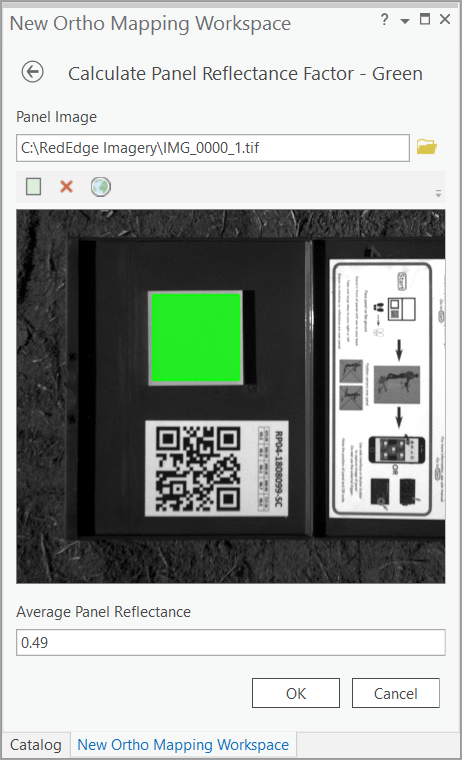

    6. Click the Calculate button Calculate to open the Calculate panel reflectance factor window.
    7. Click the browse button and browse to and select the image of your surface reflectance panel.
    8. Click the Sketch area for calibration button and click in the reflectance calibration panel to define the panel area in the image.
      To determine the reflectance ratio for Average Panel Reflectance, visit the MicaSense panel reflectance page and use the email link to obtain the reflectance value for your panel. Make sure to provide the serial number for your panel, which is listed with the QR code on the reflectance panel.
    9. Enter the provided reflectance ratio value in the Average Panel Reflectance text box and click OK. Repeat this for the remaining bands.
      Define reflectance calibration panel
    10. Expand the Advanced Options section to expose additional settings.
    11. Optionally, edit the Band Combination parameters to reorder the band combination from the default order.
