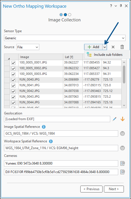

  11. Click File from Source, click the Add button to browse to a folder, and load the drone imagery for the project. If the images are in subfolders, click the Add images drop-down menu and select Include Sub folders option.
    If you want to provide a folder instead of listing all images, you can click Folder from Source drop down menu to create the workspace. You can check the checkbox Include Sub Folders to include sub folders. Make sure images in one folder are captured by the same camera. The camera can be different for different folders. Also make sure the folder provided contains images, or a warning will be displayed and the Next button will be greyed out.
