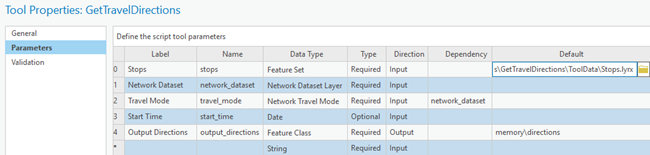

The image below shows the various parameters defined for the GetTravelDirections tool:
GetTravelDirections tool parameters
The GetTravelDirections tool parameters are shown.
The tool uses the Feature Set data type for the stops parameter. This adds the ability to specify the input stops interactively. The schema and the symbology for the feature set are defined from the Stops.lyrx file in the ToolData folder. This allows you to enforce the constraint that the input stops can only be specified using a point geometry and also allows you to predefine the set of attribute fields supported by the input. If you do not define the schema, the users of your service can specify any geometry type for the feature set.
Note:
Specifying the schema for a feature set does not prevent users of your service to pass unsupported fields. In your tool's implementation, you can list all the input fields provided to the service and decide how the tool should behave if it gets fields that are not defined in the schema. In most cases, you can ignore the fields that are not defined in the schema.
The tool uses the Network Dataset Layer data type for the network_dataset parameter. This allows you to specify a network dataset using a network dataset layer from the map. The other valid data types for specifying a network dataset are Network Dataset and Network Data Source. The Network Data Source data type allows you to specify a network dataset on disk, a network dataset layer from a map, or a URL to an ArcGIS Online or ArcGIS Enterprise portal configured with routing services. In this example, you do not want to use routing services from a portal to run your analysis so you should not select the Network Data Source data type. The Network Dataset data type allows you to specify a network dataset only using the path to its disk location. While the GetTravelDirections tool can work with a network dataset specified using its path, this is not recommended, as the tool connects to the network dataset for every request, which is slow and increases the response time of the request.
Tip:
Using a network dataset layer improves the overall tool execution time since the network dataset layer keeps a connection to the network dataset open. Otherwise, if the network dataset is referenced by the path to its disk location, a connection to the network dataset is made each time the tool executes, which reduces the performance of the geoprocessing service created from the tool.
The tool uses the Network Travel Mode data type for the travel_mode parameter. The network_dataset parameter is set as a dependency for the network_travel_mode parameter. This causes the tool to read the travel modes defined on the network dataset and populate their names as the list of possible values supported by the travel_mode parameter.
The tool uses the Date data type for the start_time parameter. This parameter is optional and does not define a default value. In the tool's implementation, if a value is passed for the start_time parameter, it is used to calculate the travel time that uses travel speeds based on historical traffic patterns observed for that date-time value. If no value is passed for the start_time parameter, the tool calculates travel time based on a fixed travel speed.
The tool uses the Feature Class data type for the output_directions parameter. The parameter is marked as an output parameter by setting its Direction property. The default value for this parameter specifies that the output is written to a feature class in a memory-based workspace .
Tip:
Writing outputs to a memory-based workspace compared to a file geodatabase improves the performance of the geoprocessing service created from the script tool. In most cases, you should write outputs from your geoprocessing tools that perform network analysis to a memory-based workspace. The output should be written to a file geodatabase if you know your tool will produce large outputs that cannot be stored in the memory of the server machine running the geoprocessing service.
