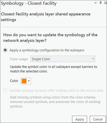

    Apply single color symbology to the sublayers.
  3. Click Apply a symbology configuration to the sublayers.
  4. Choose Single Color from the Color usage drop-down list.
  5. Choose a color and click Apply.
    All the sublayers of the network analysis layers, except the barriers, now use the same color renderer.

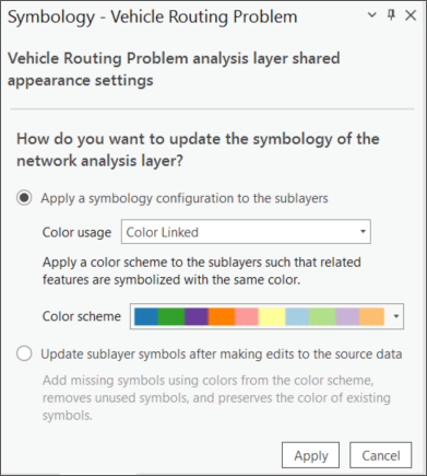

    Apply color linked symbology to the sublayers.
  4. Choose Color Linked from the Color usage drop-down list.
  5. Choose a color scheme and click Apply.
    The color scheme is applied to the sublayers, and related features are symbolized with the same color.

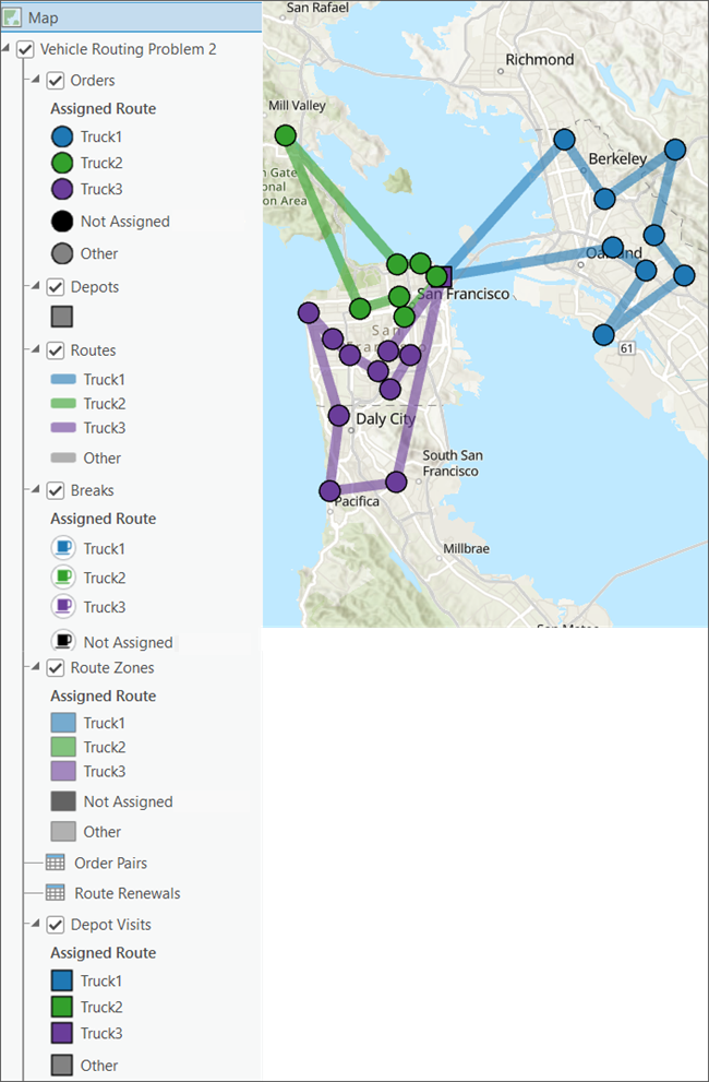

Color linked symbology for Vehicle Routing Problem layers
Vehicle Routing Problem layers use color linked symbology by default. In a Vehicle Routing Problem layer, unique routes are defined by the rows in the Routes sublayer. When color linked symbology is applied, symbol classes and colors are created for each row. Features in the Orders, Breaks, Depot Visits, and Route Zones sublayers are assigned colors matching the route with which they are associated.
Sublayers are assigned colors matching the route with which they are associated.

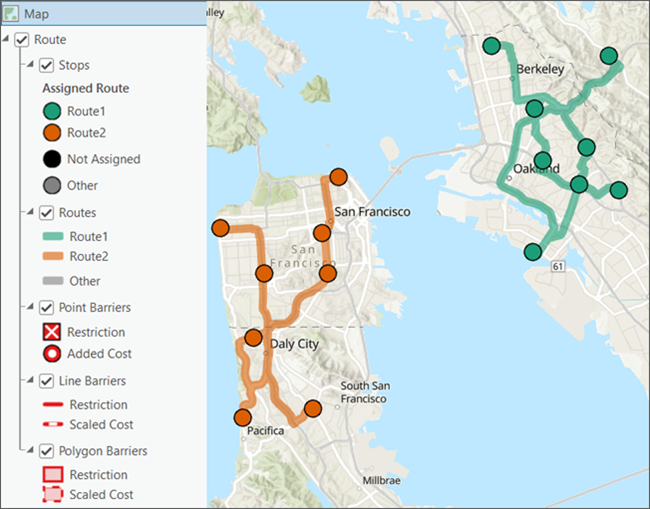

Color linked symbology for Route layers
Route layers do not use color linked symbology by default but you can change that.
In a Route layer, unique routes are defined in the Stops sublayer's RouteName field. When color linked symbology is applied, symbol classes and colors are created from the unique values in that field. Stops with the same RouteName value are assigned the same color, and the feature in the Routes sublayer with the corresponding Name field value is symbolized with a matching color.
Stops and routes with the same route name value are assigned the same color.

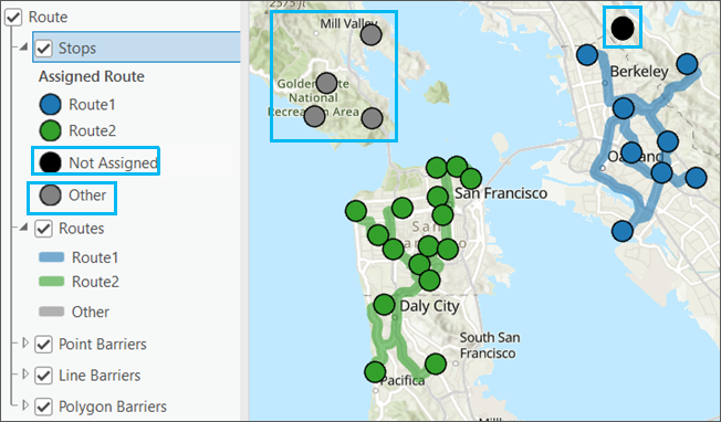

Color linked symbology is configured for a network analysis layer's current state. However, if the sublayers are updated, the symbol classes and renderers do not update until the layer is solved or the symbology configuration is explicitly updated using the Symbology pane. For example, if you add a new route or load orders that have not yet been assigned to a route, the symbology does not automatically update.
The Not Assigned symbol class is used for features that are not assigned to a specific route. New network locations created or loaded use the Not Assigned symbol class until they are assigned to a route.
The Other symbol class is used for features that are assigned to routes that do not have an assigned symbol class and color. This situation typically arises when new network locations are assigned to new routes but the analysis has not been solved or the symbols have not been explicitly updated to assign colors to the new routes.
Features not assigned to a specific route are symbolized in black, and features assigned to a route but until the analysis is run are symbolized in gray.
When edits are made to the sublayers, the edited features are symbolized as Other or Not Assigned. To apply appropriate symbology to the edited features, the network analysis layer must be solved or you can update the symbology from the Symbology pane. Complete the following steps to apply the color scheme to the edits made to the sublayer:

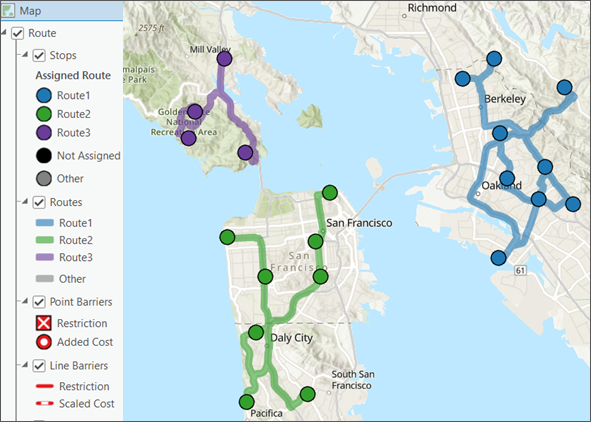

  3. Click Update sublayer symbols after making edits to the source data and click Apply.
    The color scheme is updated to match the edits made to the sublayer data.
    Symbology updated for the edited features
