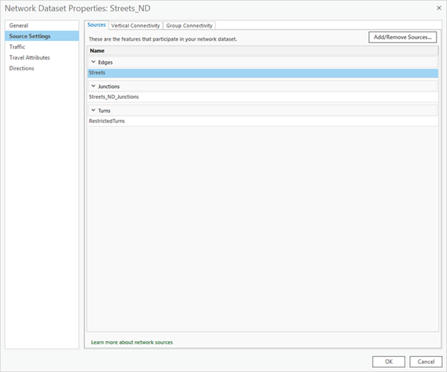

Source Settings tab
Edges and junctions form the basic structure of a network. Connectivity in a network deals with connecting edges and junctions to each other. Turns are optional elements that store information about a particular turning movement; for instance, a left turn is restricted from one particular edge to another.

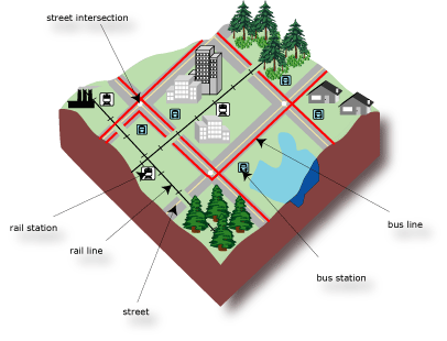

Consider the example of a simple transportation network and the sources that participate in its creation. This network has a streets feature class that can act as an edge source, a street intersections feature class acting as a junction source, additional line feature classes that act as edges (rail lines and bus routes), and point feature classes that act as junctions (rail stations and bus stations).
Simple transportation network features

Add or remove network sources
Additional source feature classes can be added or removed from a network dataset. Complete the following steps to add or remove network sources:
  1. Open the Network Dataset Properties dialog box.
    Learn how to open the Network Dataset Properties dialog box
  2. Click Source Settings > Sources.
    The page displays all the source feature classes that currently participate in your network dataset.
  3. Click the Add/Remove Sources button in the upper right corner of the dialog box.
    The Add/Remove Sources dialog box appears.
  4. Check or uncheck the feature class check boxes to add or remove them from your network dataset.
    Some of the check boxes may be unavailable. Hover over an unavailable check box to learn why it can't be added or removed from the network dataset. For example, the system junction feature class is required in the network dataset and cannot be removed.
  5. Click OK to close the Add/Remove Sources dialog box.
    Changes are reflected on the Sources tab.
    Note:
    If the source that is added or removed changes the connectivity, update the elevation connectivity and group connectivity settings on the respective tab.
    If the source that is added or removed affects the configuration of your network attributes, go to the respective network attribute tab and correct the evaluator settings for each affected attribute.
  6. Click OK on the Network Dataset Properties dialog box to save the changes to the network dataset.
