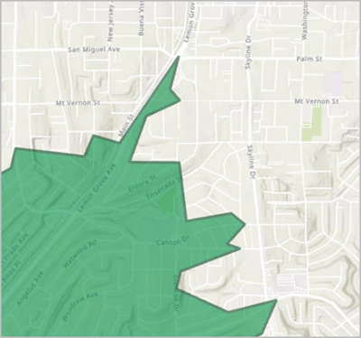

Service areas measure the reach of a facility along the network, so the most accurate output is line features, which follow along the network edges that are within reach. Creating polygons from the traversed edges is somewhat subjective because the network analysis doesn't measure off the network. The following series of images shows how output polygons differ.
  • Generalized polygons—Measurements largely ignore lower-order roads and focus on higher-order roads. Some of the local roads covered by the polygon cannot truly be reached.
    Generalized polygon

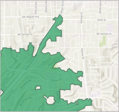

  • Standard Precision polygons—These polygons have somewhat more detail. The quality improvements are especially noticeable on curved roads: the polygons follow the curves better.
  • High Precision polygons—The obvious difference between high-precision polygons and the others is that they contain holes where network edges exist but couldn't be reached due to a long, circuitous access road or, more often, restrictions that prohibit travel on those edges. For example, enabling a restriction to prohibit travel on private roads would cause the resultant polygon to have holes around private roads.
