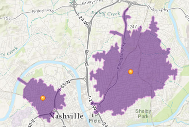

This field stores the additional time, distance, or other travel cost for the facility. Adding a value to this field reduces the reach of the service area.
For example, if you're finding the service areas for three facilities using the DriveTime impedance attribute as the cost, the Attr_DriveTime field can be used to store the amount of time spent at the facility.
For example, when calculating service areas that represent fire station response times, the Attr_DriveTime field can store the turnout time for each fire station, which is the time it takes a crew to put on the appropriate protective equipment and exit the fire station. Assume Fire Station 1 has a turnout time of 1 minute and Fire Station 2 has a turnout time of 3 minutes. If a 5-minute service area is calculated for both fire stations, the actual service area for Fire Station 1 would be 4 minutes (since 1 of the 5 minutes would be required as turnout time). Similarly, Fire Station 2 would have a service area of 2 minutes from the fire station.
Service areas with different drive time values

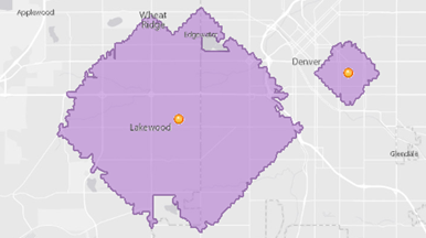

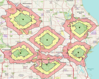

You can store different polygon break values for each service area facility in the Breaks_[Cost] field. For example, for two facilities, you can generate 5- and 10-minute service area polygons for one facility and 6-, 9-, and 12-minute polygons for another facility.
Service areas with different polygon breaks for different facilities
Multiple breaks should be specified using a space-separated string. For example, to specify 6-, 9-, and 12-minute polygons for a given facility, the field value should be 6 9 12.
The value specified in the Breaks_[Cost] field overrides the Cutoffs analysis layer setting. If no value for the Breaks_[Cost] field is specified, service area polygons are generated for the facility based on the Cutoffs setting.

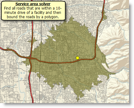

The Polygons feature class stores the resultant service area polygons, which cover the areas of the network that can be reached within the given time, distance, or other travel-cost cutoff. This feature class doesn't provide inputs to the analysis layer—it stores output information only.
To generate the Polygons feature class, on the Service Area Layer tab, in the Output Geometry group, set Output Shape Type to Polygons or Polygons and Lines .

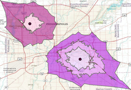

The Cutoffs property is used when a facility's Breaks_[Cost] field value is null. Suppose you have two facilities, A and B, for which you want to find a drive-time area. Facility A has a Breaks_DriveTime value of 3. Facility B has no value for its Breaks_DriveTime field. When you find the service area with Cutoffs set to 5 (minutes), facility A will have a 3-minute service area, and facility B will have a 5-minute service area.
Override and default cutoffs
Note:
Use the Cutoffs property to assign default values to facilities that do not have numeric values stored in the Break_[Cost] field.
Multiple polygon breaks can be set to create concentric service areas. For example, to find 2-, 3-, and 4-minute service areas for each facility, type 2, 3, 4 in the Cutoffs text box.
