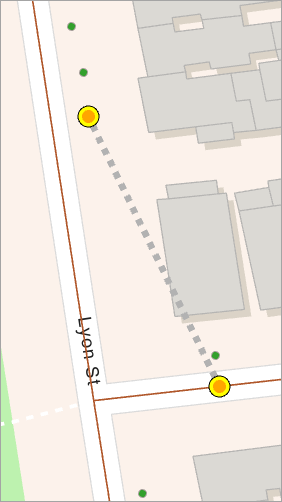

When you perform a network analysis, the inputs to your analysis rarely fall exactly on top of the edges or junctions of the network data source you are using. For example, you may be using a network dataset constructed from street center lines, but the points you want to analyze are the centroids of parcels in your city. These parcel centroids do not fall on top of the street center lines; rather, they are offset some distance from the streets. To successfully perform a network analysis, you must determine the location on the network dataset where each analysis input lies. This network location, rather than the input's original location, is used in the analysis.

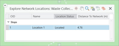

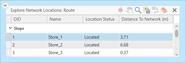

When you click an analysis input with the Explore Locations tool, the explore locations overlay shows detailed information about the input’s network location and location status. Use this information to better understand the network location. The data grid shows the selected network locations, grouped by their sublayer. For each selected location, its ObjectID (OID), Name, Location Status, and Distance to Network are shown. This information is pulled from the OID, Name, Status, and DistanceToNetworkInMeters fields from the network analysis sublayer. Learn more about network location fields .
Additionally the overlay includes additional functionality to explore the network location in the map and in the network analysis layer sublayer attribute tables.
  • Flash—Flash the located network position of the active input location analysis point feature.
  • Pan—Pan to the active explored input location analysis point feature.
  • Zoom To—Zoom to the active input location analysis point feature and its located position.
  • Select the active input location analysis point feature.
  • Load the selected input location analysis features.
  • Clear—Clear explored input location analysis point feature results.
Explore locations overlay

The Located status indicates that the network location is on the closest street.
Located
Input point located on the map

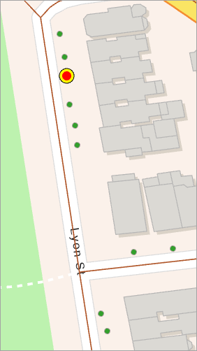

The Indeterminate status indicates that the point geometry has not been located since creation. Locating happens during the running of the Add Locations tool and at solve time.
Indeterminate
Location of point is indeterminate

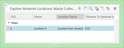

The Located (not closest) status indicates that the network location is not on the closest street to the point geometry. This could be due to a restriction on the closest street or because of a barrier feature.
Not located on the closest street
Point located is not on the closest street

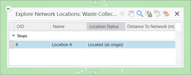

The Located (at origin) status indicates that network location is at the origin of the coordinate system (0,0). This occurs when using Add Locations using network location fields. The SourceID, SourceOID, and PosAlong fields are populated by Add Locations, but the SnapX and SnapY fields are left at their default values of 0.
Network location located at the origin
Point is located at the origin

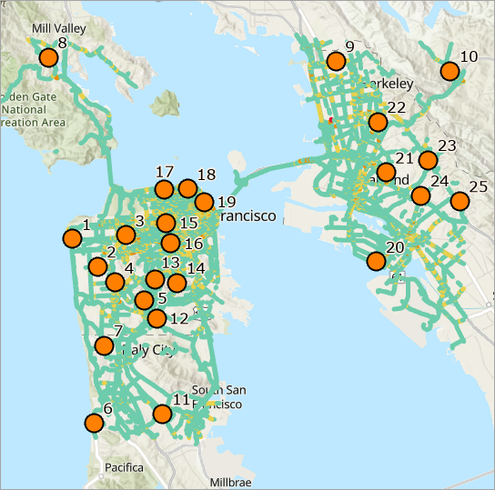

  1. Create a network analysis layer.
  2. Load input data for the current analysis layer.
    In the below image, stops are imported in the Stops sublayer of the Route analysis layer using the Add Locations tool.
    Input locations in the Route analysis layer

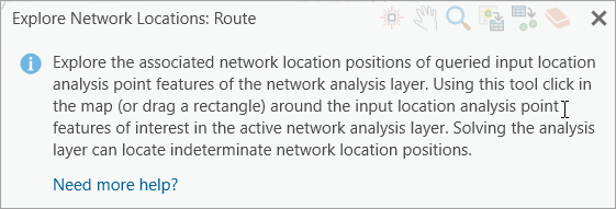

  4. Click the Route Layer > Input Data > Explore Locations tool.
    The Explore Network Locations: Route window appears. You can move around the window on the screen for appropriate placement.
    Note:
    For illustration, the Route layer has been used and therefore the dialog box title has Route. The analysis layer name will be the one you are working on currently.

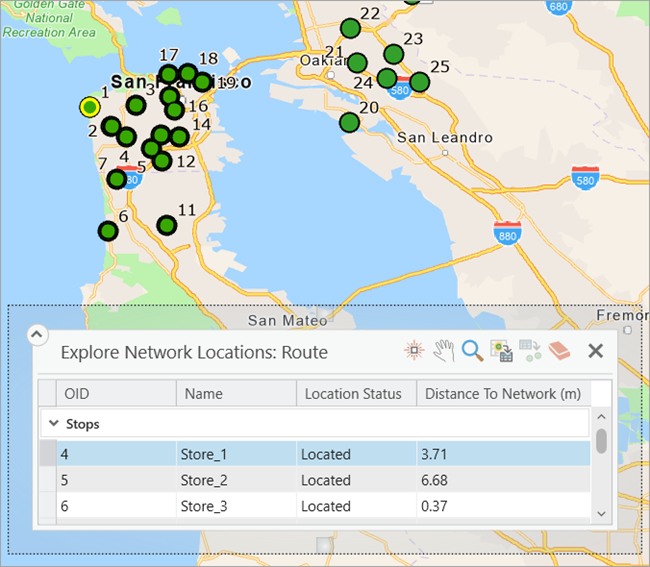

    With the tool activated, you can either select a single point feature on the map or draw a box around a collection of input points.
  5. Draw a box around a collection of input points.
    The selected point features get populated in the Explore Network Locations: Route window and the tools on the upper right corner of this window get enabled.
    Selected input locations get populated in the overlay window
You can now visualize and diagnose any location problems with the input features.
