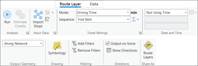

To share a route or closest facility analysis results as a route layer, click the Share As Route Layer button in the Share As group on the Route Layer, Closest Facility Layer, Last Mile Delivery Layer, or VRP Layer tab.
The Share As Route Layers tool opens, allowing you to share the active network analysis layer as a route layer to the active portal.

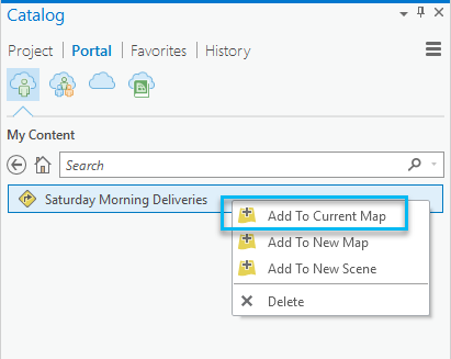

To edit a route layer, you create a route analysis layer from a route layer. Select the route layer on the Portal tab in the Catalog pane and add it to the current map.
Add a route layer in the Catalog pane to the current map.
A new route analysis layer is created from the route layer that you can modify using the Route tab on the ribbon.
