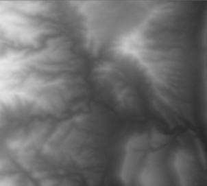

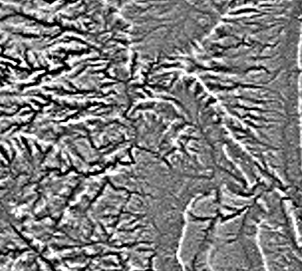

DEM view Curvature surface

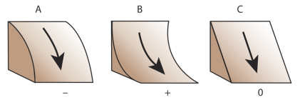

Profile
The Profile curvature is parallel to the slope and indicates the direction of maximum slope. It affects the acceleration and deceleration of flow across the surface. A negative value (A) indicates that the surface is upwardly convex at that cell, and flow will be decelerated. A positive profile (B) indicates that the surface is upwardly concave at that cell, and the flow will be accelerated. A value of zero indicates that the surface is linear (C).
Profile curvature
Profile curvature

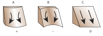

Planform
The Planform curvature (commonly called plan curvature) is perpendicular to the direction of the maximum slope. Planform curvature relates to the convergence and divergence of flow across a surface. A positive value (A) indicates that the surface is laterally convex at that cell. A negative plan (B) indicates that the surface is laterally concave at that cell. A value of zero indicates that the surface is linear (C).
Planform curvature
Planform curvature

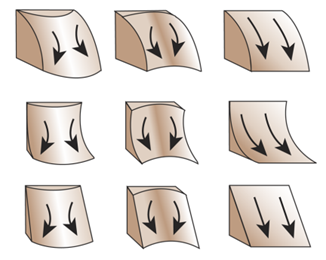

The Standard curvature combines both the profile and planform curvatures. The profile curvature affects the acceleration and deceleration of flow and, therefore, influences erosion and deposition. The planform curvature influences convergence and divergence of flow. Considering both planform and profile curvature together allows you to understand more accurately the flow across a surface.
In the following diagram, the columns show the planform curves, and the rows show the profile curve. The planform columns are positive, negative, and 0—going from left to right. The profiles curves are negative, positive, and 0—going from top to bottom.
Standard curvature
Standard curvature generates both profile and planform curvatures.
