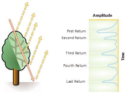

A single pulse from the lidar sensor can be returned more than once as it reflects off objects at different heights on or above the ground, resulting in pulses returning to the sensor at different times. Therefore, the return type can be used to differentiate ground returns from other returns, such as tree canopy.
For the Returns filter, you can select Any to add all the lidar returns, or you can also select more than one. The Return types are First through Fifteenth and Last.

Lidar is an active sensor that sends out a laser pulse at a particular frequency and wavelength. This pulse is absorbed or reflected by different surfaces and received by the sensor. A single pulse from a laser can be returned as multiple signals as it reflects off objects at different heights on or above the ground, resulting in pulses returning to the sensor at different times. Therefore, the return type can be used to differentiate ground returns from other returns, such as tree canopy. The LAS To Raster function allows you to select one or more return values.
Diagram of return types
Comparing the timing and intensity of return signals.
