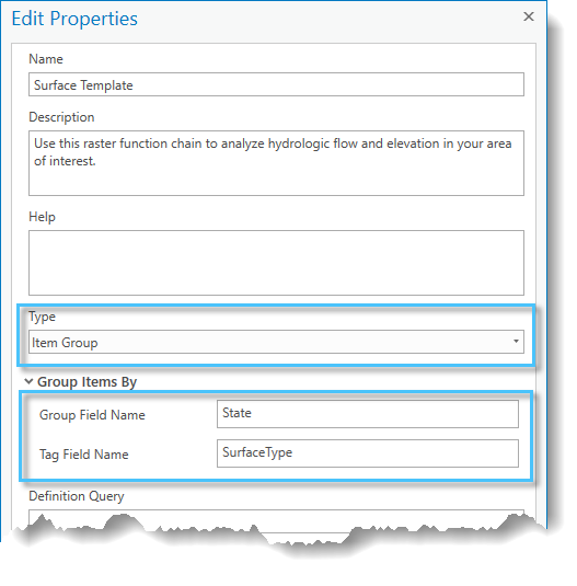

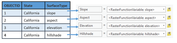

    1. Identify the fields in your mosaic dataset attribute table that will be used as the Group Field Name and Tag Field Name. These can be fields that exist in your mosaic dataset, or you can create and populate fields. The Group Field Name references the field used to define the collection of rasters in your mosaic dataset that will be passed into the template. In the example above, State is used as the Group Field Name, where all rasters with the same State value will be passed to the template together. The Tag Field Name references the field that is used to identify each individual item within a group. In the example above, SurfaceType is used as the Tag Field Name.
    2. Open the raster function template properties dialog box by right-clicking a raster function template in the Raster Functions pane or clicking Edit Properties in the Function Editor pane.
    3. Set the Type to Item Group on the Edit Properties dialog box. This configures the template to work on items in the mosaic dataset.
    4. Provide field names for Group Field Name and Tag Field Name.
      Set the Group Field Name and Tag Field Name parameters in the raster function template editor.
  2. Match the values from the tag field with the names of the inputs in your raster function template.

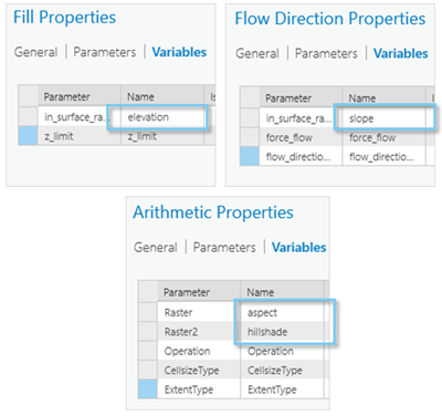

    2. Right-click a function in the function chain and click Properties or double-click the function to open the properties dialog box for the function.
    3. Click the Variables tab to set the name of each variable input. In the example above, slope, elevation, aspect, and hillshade are used to identify the item in the mosaic dataset to use.
      Set the variable values to the values of the tag field for each raster function in the function template.

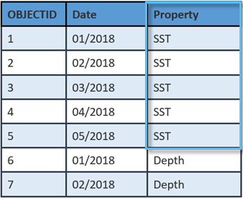

Mosaic dataset attribute table showing date and the property being displayed in each raster.

  3. Provide field names for Group Field Name and Tag Field Name. In the example above, Property is used as the group field such that all raster items displaying the same property, such as SST and ocean depth, are passed to the raster function. The Date field is the tag field.
