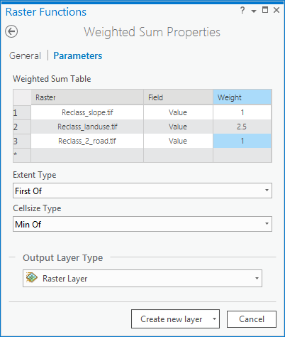

Weighted Sum Table
The weighted sum table is defined by three properties:
  • Raster—The raster being weighted.
  • Field—The field of the raster to use for weighting.
  • Weight—The weight value by which to multiply the raster. It can be any positive or negative decimal value.

Extent Type
Choose which extent should be used in the output raster:
  • First Of—Use the extent of the first input raster to determine the processing extent.
  • Intersection Of—Use the extent of the overlapping pixels to determine the processing extent. This is the default.
  • Union Of—Use the extent of all the rasters to determine the processing extent.
  • Last Of—Use the extent of the last input raster to determine the processing extent.
