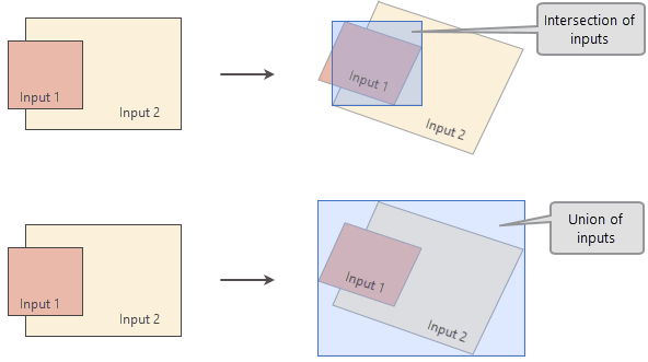

The initial extent is determined in the output coordinate system by projecting all datasets used in the analysis to the same coordinate system. It can be defined by numeric values or obtained from an existing raster dataset.
If the extent hasn’t been explicitly specified in the tool parameter, it is derived from the Extent environment if it has been set. Otherwise, the initial extent is derived from the inputs, which could be the intersection of or union of input dataset extents, based on the tool. See the figure below for an illustration of these two scenarios.
Determining initial analysis extent
Initial analysis extent as derived from the intersection and union of inputs.
For some tools, such as Zonal Statistics, the intersected extent is further adjusted to align cells with one of the input rasters.

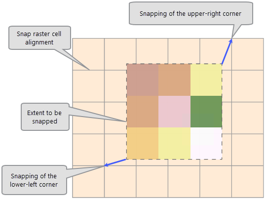

The final analysis window is determined by combining the initial analysis extent, the output cell size, and the snap raster. When no snap raster is specified, the lower left corner of the initial analysis extent will automatically become the lower left corner of the final analysis window. If a snap raster environment is specified, the lower left corner of the final analysis window is moved to the nearest snap raster cell corner in such a way that the new lower left corner is outside of the initial analysis extent, as shown below:
Snap raster
Extent to be snapped
The width and the height of the final analysis window, known as the output extent, are determined using multiples of the output cell size. The upper right corner of the analysis window is adjusted in such a way that the initial analysis extent falls within the output extent. This might increase the extent of the output raster compared to the initial extent. To learn more about the snap raster environment, see How the Snap Raster environment setting works.
