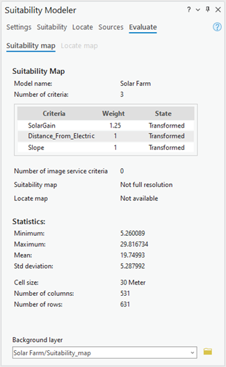

On the Evaluate tab, select which map type to investigate, the Suitability map or the Locate map.
When Suitability map is selected, the tab displays the input model criteria, whether the criteria are transformed, if the suitability or locate maps are run at full resolution, and the statistics of the suitability map.
To select the Locate map option, the suitability map must be run at full resolution and the locate map created. When the Locate map is selected on the Evaluate tab, a plot of the resulting regions and the statistics of the regions are displayed.
When either the Suitability map or Locate map is selected, you can specify the layer that will be used as the background layer.
The Evaluate tab of the Suitability Modeler pane
