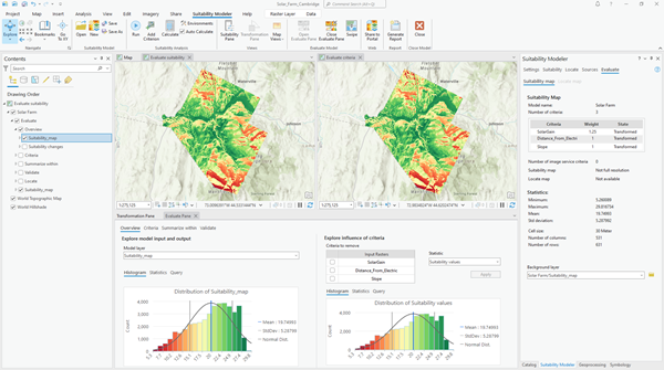

An example of the Evaluate Pane is shown below.
The Evaluate environment
The Evaluate environment includes the Evaluate tab, the Evaluate Pane, two maps, and specific contents.
The Transformation Pane, in conjunction with the Evaluate Pane, can be used to further refine the model from discoveries made in the evaluation. These refinements to the model are immediately updated in the Evaluate Pane.

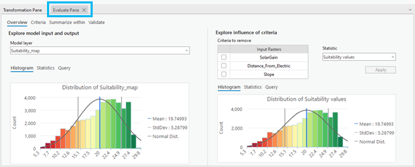

Evaluate Pane
The Evaluate Pane uses a series of tabs and panels to explore the interactions between the criteria.
The Overview tab of the Evaluate Pane is shown.

Tab panels
Each tab is divided into two sections or panels.
The panel on the left controls the parameters and statistics for the Evaluate suitability map as well as the accompanying plots and output statistics. Use this panel to investigate how the composition and interaction of the input criteria combine to produce the final suitability values for a cell, decision unit, observation, or identified region. Maps, plots, and statistics will display the results. In the image above showing an example of the Evaluate Pane with the Overview tab selected, the left panel has the title Explore model input and output.
The panel on the right controls the parameters and statistics for the Evaluate criteria map and the accompanying plots and output statistics. Use this panel to investigate how a particular criterion contributes to the final suitability values for a cell, decision unit, observation, or identified region. Maps, plots, and statistics will display the results. In the image above showing an example of the Evaluate Pane with the Overview tab selected, the right panel has the title Explore influence of criteria.
