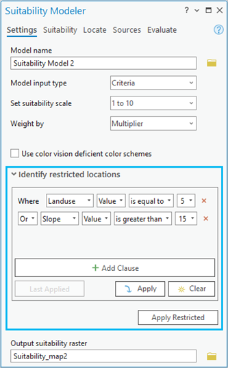

You identify the locations to restrict in the Suitability Modeler pane, on the Settings tab, in the Identify restricted locations part of the panel.
Identify restricted locations query builder
An example of the identify restricted locations query builder with two Where clauses set.

  1. In the Suitability Modeler pane, click the Settings tab.
  2. Expand Identify restricted locations to see the query builder.
Additional controls are available to modify and apply the expression.
Add clauses to the restricted expression
Add Where clauses to identify which locations are restricted and should not be considered in the model calculations.
  1. In the Identify restricted locations query builder, click the Add Clause button.
    A default Where clause is added to the expression.
  2. Alter the default clause to define the initial restriction to apply to your model.
    It is recommended that you click the Apply button after entering each clause to create or update the Restricted map and see the locations that meet the current active expression.
  3. Click the Add Clause button again to add an additional clause to your expression.
Remove clauses from the restricted expression
If you have entered a clause that is wrong or you decide a restriction no longer applies to your suitability model, you can remove the clause.
  1. In the Identify restricted locations query builder, click the Remove this clause from the active restricted expression button to the right of each clause you want to remove.
  2. To remove all the clauses and restart building an expression, click the Clear button.
