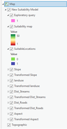

The suitability group layer in the Contents pane stores the model base criteria, the transformed criteria, the final suitability map, the locate layer, and the query layer.
Suitability group layer example
The suitability group layer is a standard group layer in the Suitability Modeler.
