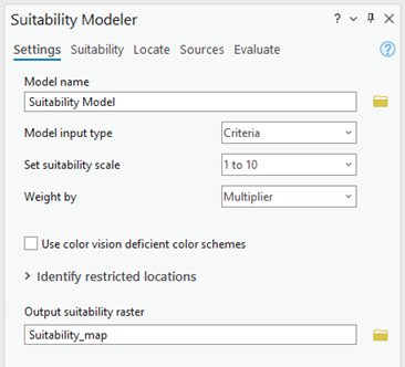

  • The Suitability Modeler pane appears, containing the Settings, Suitability, Locate, and Sources tabs. Settings is the active tab.
Settings tab of the Suitability Modeler pane
The Settings tab of the Suitability Modeler pane with default values is shown.
On the Settings tab, you can name the model, select the suitability scale, and indicate the method to use for weighting the criteria. Once you name the model and specify the model settings, click the Suitability tab to create the suitability map.

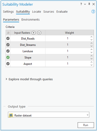

The Suitability tab of the Suitability Modeler pane with four criteria is shown.
The Suitability tab and the accompanying Transformation pane are where you address the first three steps of the suitability workflow. Step 4, addressed on the Locate tab, is where you define the site or preservation area.

To transform a criterion to a common suitability scale, click the circle button next to the criterion in the criteria list on the Suitability tab. The following occur:
  • The Transformation Pane appears.
  • A transformed layer of the criterion is added to the suitability group layer in the Contents pane.
  • A default transformation is applied based on the type of the input values.
The button next to the criterion turns green, indicating it is the active criterion in the Transformation Pane. The button turns grey once the criterion has been transformed and is no longer the active criterion in the Transformation pane.

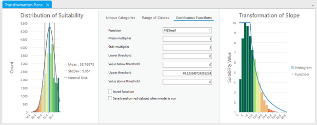

You can apply a transformation method other than the default. As you click each method or function in the Continuous Functions method, parameters applicable to the method or function appear, allowing you to further refine the transformation.
Transformation pane
The Transformation pane and its components are shown.
The Transformation pane has three sections you can use to select the best transformation method for the input criteria values.
A histogram of the final suitability values is on the left.
You can use the plot on the right to help you select transformation methods and functions. The plot depicts how the input values will be converted to the suitability scale. In the plot, the x-axis contains the base criterion input values, the y-axis contains the suitability scale, and a histogram of the base criterion values is displayed. For the Continuous Functions method, the function being applied is overlaid on the plot. As different methods or functions are applied, the plot is updated.
As you explore the methods and functions and their parameters, the transformation plot, the final suitability histogram, and the transformed and final suitability map layers in the suitability group layer in the Contents pane are updated. This updating provides feedback about the effects that transformation will have on the transformed criterion as well as the impact to the final suitability map.

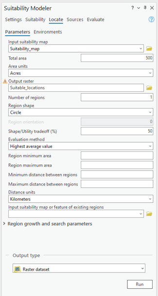

On the Locate tab, specify the spatial requirements for the suitability model. Up to this point, the calculations were performed only on the data presented at the display extent and resolution. Before you locate your areas, run the model at the full resolution and extent of the source input. To do this, click the Run button on the Suitability tab.
Locate tab of the Suitability Modeler pane
The Locate tab of the Suitability Modeler pane is shown.
The resulting suitability map is the input to the Locate tab. The locate component of the suitability modeling process allows the spatial requirements to be specified. The total area, number of regions, and shape characteristics of the desired areas are identified. You can also specify the minimum and maximum region sizes and distances between regions. Click Run on the Locate tab or the Run button on the Suitability ribbon. A new Locate layer that identifies the best locations to site or preserve is added to the suitability group layer in the Contents pane.
