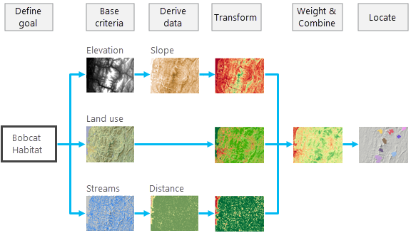

The following image illustrates the sample suitability model workflow:
Sample suitability modeling workflow
A sample suitability modeling workflow is shown.
