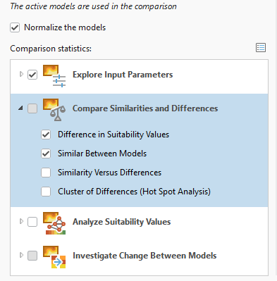

  • The Comparison pane is used to name the model, identify the models to compare, set if the models should be normalized or not, and select the predefined statistics you wish to run.

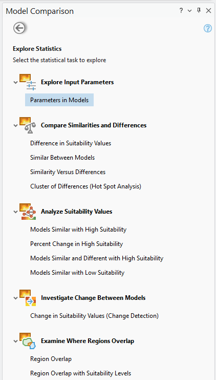

  • The Explore Statistics pane is activated once the predefined statistics have been run from the Comparison pane. On the pane, you select the predefined statistics you wish to view and explore.

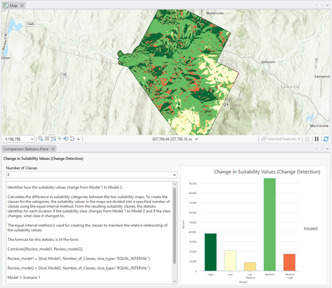

  • Investigate Change Between Models includes a number of statistics to identify how the suitable categories change between the models.

  4. Determine if the models should be normalized (put on a 1 to 100 common scale if their suitability values vary) so they can be compared. If so, click the check box next to the Normalize the models parameter.
    By default, the parameter is checked.
  5. In the Comparison statistics list in the Comparison pane, select the predefined statistics to run.
    Two statistics have been selected to run
    The Difference in Suitability Values and Similar Between Models statistics have been selected to be run.
  6. Click the Run button to generate the statistics.

  7. In the Explore Statistics pane, select the statistic to view and explore.
    The controlling parameters, plots, statistics, and interpretive text for the statistic are displayed in the Comparison Statistics Pane.
    The resulting map from the statistic is displayed in the Map view.

  8. In the Comparison Statistics Pane, you can alter the parameters for the statistic as desired.
    The interpretive text provides both an explanation of the statistic and a formula you can use to adjust the parameters.
  9. Click another statistic in the Select the statistical task to explore list in the Explore Statistics pane.
