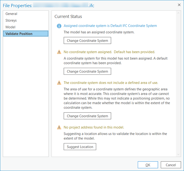

The position validation workflow is on the Validate Position option of the CAD or BIM file data properties dialog boxes, which you can access through the Properties context menu of the data file items in the Catalog view. Status messages are displayed, and actions are provided to help you in the positioning validation and mitigation workflow. The main goal of the positioning validation workflow is to validate a properly positioned file, or reposition the data near to where it should be before the data is positioned using the ArcGIS Desktop georeferencing tools.
Validate Position tab from BIM data file properties
Change Coordinate System
The validation status messages identify the Esri coordinate system definition assigned to the data. For CAD and BIM data, this coordinate system definition is in the form of a PRJ file. When no definition is found, a default coordinate system may be assigned or inferred from spatial location data in the file. Data files drawn to the assigned Esri coordinate system definition with the correct linear units will be positioned correctly in ArcGIS Desktop without a need for further validation.

If the data has been assigned an Esri coordinate system definition, additional validation will check the data's coordinate system with the selected coordinate system's defined area of interest and display a status message with the result of that comparison.
Status messages are provided to validate if the model coordinates fit within the area of interest of the assigned coordinate system. A fit suggests that the coordinate system is appropriate for the data. However, if you want or need to change the data's coordinate system definition to fit other data, you can choose a different coordinate system by clicking the Change Coordinate System button. If the data was drawn in a relative coordinate system or no coordinate system, you can choose any coordinate system that matches the linear units of the data. Not all coordinate system definitions have a defined area of interest.
If the data was drawn according to the assigned coordinate system with the appropriate linear units, the data will be positioned correctly in ArcGIS Desktop and the data can be used without further validation.
If there is no area of interest defined for the coordinate system definition, it can still be appropriate for the data. However, if the data does not fit within the area of interest, you may have assigned the wrong coordinate system definition or you need to georeference the data to offset the model coordinates with a transformation world file WLD3. If the coordinate system definition is correct and the data file coordinates don't fit the data, it is likely the data was not drawn to this coordinate system. Adjust it using a coordinate system adjustment WLD3 file using the geoprocessing workflow for CAD or BIM in ArcGIS Desktop. You can also create a world file that positions the data closer to the intended position using a suggested location. If the assigned coordinate system is not appropriate for the data because the default coordinate system was not appropriate, the linear units do not match the data, or for any other reason, click the Change Coordinate System button and assign the correct coordinate system definition.
If the data has not been assigned an Esri coordinate system definition, you must assign a coordinate system for the data before you can proceed with the validation and before you can use the data in ArcGIS Desktop. Click the Change Coordinate System button to select a coordinate system.
The Change Coordinate System button provides direct access to the Define Projection geoprocessing tool to assign a coordinate system definition PRJ file to the data if one does not exist or if you need to change it.

If the data doesn't have an existing WLD3 file and you want to reposition the data close to its final location before georeferencing the data in ArcGIS Desktop, you can use a suggested location. A suggested location can help locate the data near to where it should be positioned. If the data file has an existing WLD3 file, add the data to a map to see whether the data is positioned correctly before adding a suggested location. A CAD or BIM data file may have an address or suggested location that is read from the properties of the file. If you have more accurate information and want to specify the suggested address or place-name for the data, you can provide this information by clicking the Suggest Location button. If a valid geospatial location is found from the current map's locator, its position will be compared to the data file's coordinate extents, and a message will be generated to identify whether that location is within the spatial extent of the data.
If the data has a suggested address, it is used to find a geographic location using the locator of an open map in ArcGIS Desktop. This information is only needed if you intend to transform the coordinates of the data to be near this location to georeference it.
To provide an address or placename for the data if you have a map open in ArcGIS Desktop, click the Suggest Location button. This information is only needed if you intend to transform the coordinates of the data to be near this location to georeference it.
To use the Suggest Location button , you must have a map open in ArcGIS Desktop. The suggested location search string locates a geospatial position with the current map's locator.
