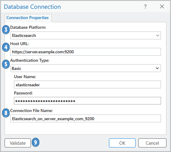

To create a connection to an Elasticsearch cluster using the Database Connection dialog box in ArcGIS Pro, complete the following steps. The numbers in the image below correspond to the numbered steps.
Connecting to Elasticsearch from the Database Connection dialog box
  1. Open the Catalog pane in ArcGIS Pro.
  2. Right-click Databases or a folder under Folders and click New Database Connection.
  3. Choose Elasticsearch from the Database Platform drop-down menu.
  4. In the Host URL text box, provide the URL to connect to the Elasticsearch cluster.
    If the cluster communicates using a port other than port 80 for HTTP connections or port 443 for HTTPS connections, append a colon (:) and the port number to the end of the URL. For example, if the host https://sub.dom2.net is communicating over port 54321, type https://sub.dom2.net:54321 for the host URL.
  5. Choose one of the following from the Authentication Type drop-down menu:
    • Basic—Use the HTTP basic username and password authentication headers.
    • API key service—Use an API key for authenticating requests.
    If you will publish web layers using this connection file, you must use basic authentication.
  6. For basic authentication, provide valid credentials in the User Name and Password text boxes.
  7. For API key service authentication, provide the API key.
  8. Provide a name for the connection file in the Connection File Name field.
    A default name is created based on the connection property values. You can use the default, or provide a more descriptive file name.
    This is the name that will appear in the Catalog pane and view, and the name of the .dbconn file stored on disk.
  9. Click Validate to confirm that the connection information is valid and the instance is accessible.
  10. Click OK to create the connection file.
