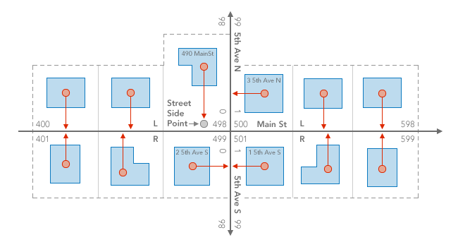

Assign Streets To Points tool illustration
In the illustration above, the rooftop point address at 490 Main St is closer to the street segment for 5th Ave N, but is linked to the left side of the Main St segment because the point is on the left side of the street based on how the segment was digitized, the street name components match, and the house number is within the house number range of the street segment. The name of the street is prioritized over the location of the point to the street segment. The street side point for the rooftop address point is generated by the Assign Streets To Points tool when the Output Geometry parameter is set to Street Point Geometry and can be used for routing. The building for the address 1 5th Ave S is at the intersection of Main St and 5th Ave S and could be linked to either Main St or 5th Ave S street segments based on location. The entrance to the building is off of 5th Ave S, so the point address is correctly linked to the 5th Ave S segment because of the similar street name components and the house number is within the house number range of 1 to 99, which is on the left side of the street.
