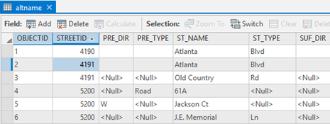

An alternate names table
Contents of an alternate name table
Names of features, such as streets, can change over time. For example, Jefferson Road is a new official name for the street that was previously called Old Country Road. You may have a neighborhood in a city or an official city name versus a commonly used name in which either could be used when searching for an address. For example, North Park is a neighborhood in San Diego. Searching for a feature by all of its possible names can increase the success rate of geocoding. The alternate name table contains fields for the additional names. Each record represents one name for a feature. Additional names can be added to the table.

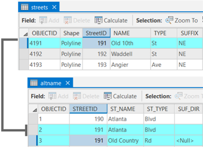

Join ID
The alternate name table must have an ID field that can be used to join the records to the primary feature class. If the alternate name table contains multiple names for a single feature, the JoinID field will contain the same value for each alternate feature name record in the alternate name table.
The primary feature class must have a field that contains a unique ID value for each record that can be used to link to the Join ID from the alternate name table.
Primary table and alternate name table for streets with StreetID to link tables together

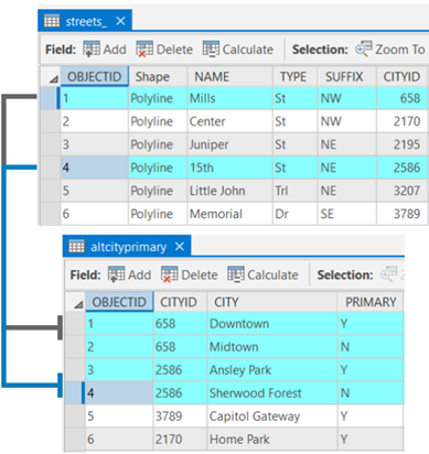

Note:
If the data is normalized and the primary table does not contain city name values, but the alternate name table does, for example, when building the locator, the Primary Name Indicator field can be mapped to a field in the alternate name table that contains a value that indicates if the record is the primary field (for example, True/False, Yes/No). If this field is not mapped, the first record in the alternate name table will be used as the primary value.
Primary street table without zone and city alternate table with primary field and CityID to link the tables
