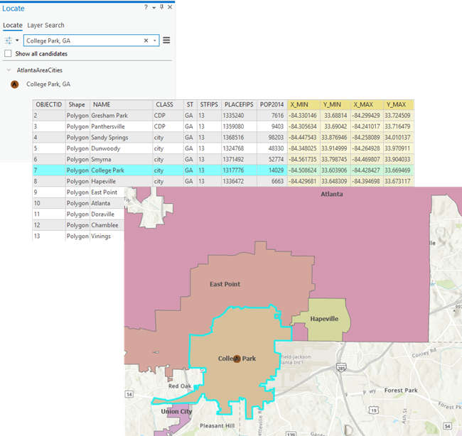

Zooming effectively to geocode results in client applications such as ArcGIS Pro and Map Viewer Classic is related to the extents that are included for each point or polygon feature in the reference data used to build the locator. The following example shows the extent coordinates defined for the feature, when extent fields are mapped during locator creation, and the zoom result of a searched location.
Zoom results using the feature extent fields
When modeling point and polygon reference data for creating locators, include the extent (bounding box) coordinates of each feature so that the client application can zoom effectively to geocode and search results. If you do not include the bounding box coordinates for the features, the geocode results use a default zoom scale, which may not be appropriate for the geocode result. Locators created with line features using the Street Address role will return geocode results using a default zoom scale and not the extent coordinates of the feature. The following four elements define the extent of the feature. The ArcGIS World Geocoding Service, for example, contains these predefined values.

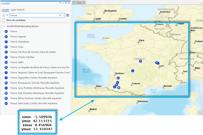

In some cases, the bounding box values generated by these tools are not appropriate for some features. In these cases, you can update these records manually to zoom more effectively to these features. For example, if you search for a country that is irregularly shaped with an outlier island and the extent is not consistent with the bounding box of the feature, you can manually adjust these bounding box values to get a better zoom experience for the user.
Zoom to geocode results based on the feature's bounding box.
