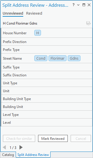

    The Split Address Review pane appears. The pane automatically divides the split addresses into two groups: Unreviewed and Reviewed. The Reviewed tab contains split addresses that have been split automatically and do not fit one of several predefined patterns that suggest an address needs additional manual review. The pane opens to the Unreviewed tab, which displays split addresses that are likely to have one of several potential problems, including all tokens split into the StName field or no StPreType or StType tokens defined.
  4. Use the Split Address Review pane to review the addresses split by the geoprocessing tool individually.
    The tool allows you to review the addresses one by one to address only the current problematic address.

  5. If any addresses are parsed incorrectly, do any of the following: drag tokens from one row into another, drag to reorder tokens on the same row, or split tokens into more than one token.
    You can drag using a mouse, or you can use the Tab and arrow keys to move tokens.
