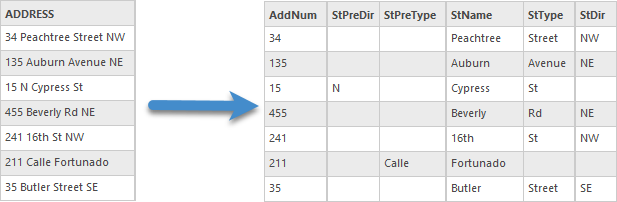

Illustration
Split Address Into Components tool illustration
