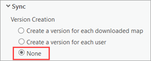

When you publish the feature layer, you must set the following on the Configure Web Layer Properties dialog box, accessed from the Configuration tab of the Share As Web Layer pane:
  • Enable editing on the feature service and choose the level of editing allowed.
  • Enable sync.
  • Set the sync option to None.
    The None option for Sync Version Creation is selected.

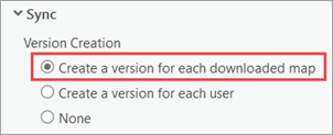

  • Enable sync.
  • Use the default sync option for version creation.
    The default Sync Version Creation option creates a version for each downloaded map.
    Do not use the None option; it will cause the collaboration to fail.
  • If editing is enabled on the feature service, the login account specified in the database connection used to access the data must be granted the privileges on the data in the geodatabase that allows them to perform the editing operations configured for the feature service. If editing is not enabled on the feature service, the login account must have privileges to select the data included in the feature service.
  • Enable sync.
