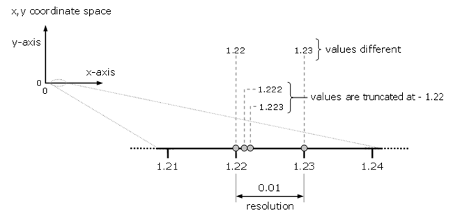

The resolution represents the detail in which a feature class records the location and shape of geographic features. It is the minimum distance, in map units, that separates unique x-values and unique y-values in the feature coordinates. For example, if a spatial reference has an x,y resolution of 0.01, x-coordinates 1.22 and 1.23 can be stored as separate coordinate values, but x-coordinates 1.222 and 1.223 are both stored as 1.22. This is illustrated in the image below. The final digit on the latter pair of x-coordinates is truncated because the change in value is less than the x,y resolution. The same applies for y-coordinates.
Resolution defines unique x and y values
