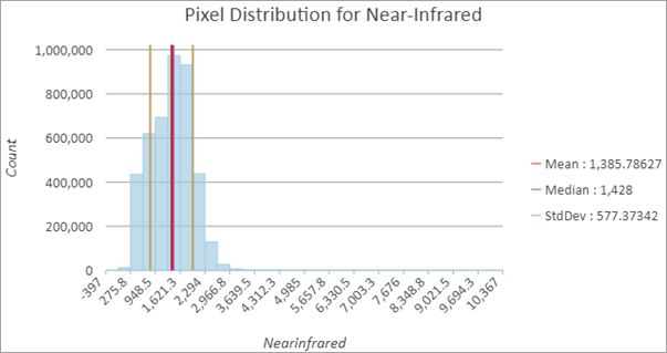

Image histogram
Image histograms visually summarize the distribution of a continuous numeric variable by measuring the frequency at which certain values appear in the image. The x-axis in the image histogram is a number line that displays the range of image pixel values that has been split into number ranges, or bins. A bar is drawn for each bin, and the width of the bar represents the density number range of the bin; the height of the bar represents the number of pixels that fall into that range. Understanding the distribution of your data is an important step in the data exploration process.
Variable
Image histograms require one continuous Number variable on the x-axis, comprised of the pixel values of a particular image band.
Image histogram of pixel values for the Landsat-8 infrared band

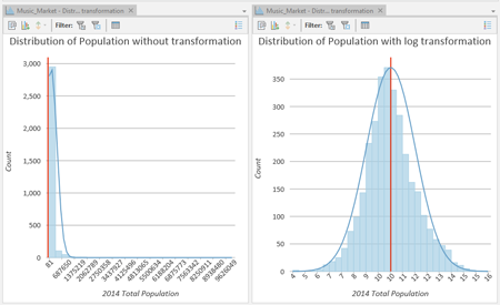

Logarithmic transformation
Logarithmic transformation is often used when the data has a positively skewed distribution and there are a few very large values. If these large values are in your dataset, the logarithmic transformation will help make the variances more constant and normalize your data.
For example, the positively skewed distribution in the chart on the left is transformed to a normal distribution using a logarithmic transformation in the chart on the right:
Chart of raw data distribution on the left compared to logarithmic transformation on the right
Note:
Logarithmic transformations can only be applied to numbers greater than zero.
