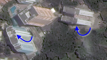

Measure a structure's height from the structure and shadow

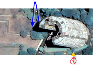

The Top To Top Shadow Height tool calculates the height of a structure by measuring from the top of the structure to the top of the structure's shadow. The points on the structure and its shadow must represent the same point.
The calculation will be refined to account for topography when an Elevation dataset is defined on the Mensuration Options dialog box.
In the example below, the point where the shadow intersects with the building (bottom of the shadow) is blocked by a tree; therefore, it should not be used. The correct way to identify the height of this building is to identify a point on the top of the building that can be identified in the top of the shadow, such as the one identified by the blue arrow.

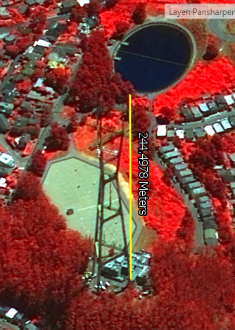

The three height measurement tools operate such that the initial measurement point becomes the endpoint of a line for the constraint. The pointer will only move along the line that is appropriate for the measurement. For instance, when the Base To Top Height measurement tool is chosen, the first point should be the base of the object. The pointer movement is then constrained in the vertical direction. This is important when measuring objects where the location of the base is difficult to discern from the top of the object. For example, it may be easy to find the edge of the base of a pyramid type of feature, but difficult to determine the center of the base. There are also instances where other endpoints of the measurement are difficult to see, and the constraint can assist you in identifying them.
Constrained Base To Top Height measurement
Constrained Base To Top measurement using an infrared image to discern the tower details against the vegetation. QuickBird-2 image courtesy of DigitalGlobe.

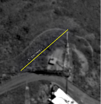

For the Base To Top Shadow Height tool, the initial point should be the base of the feature. The pointer will then be constrained to move along the path of the shadow on the ground.
