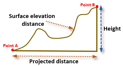

Increase the accuracy of measurements
Specify an elevation dataset in the Mensuration Options pane to calculate more accurate distance and height measurements. Otherwise, the distance or height measurement provided is a projected distance or height, measured only using the information in the image.
Refine measurements using an elevation dataset
Using an elevation dataset modifies the distance measurement to provide a measurement that accounts for terrain that may have a significant influence on the measurement; otherwise, the distance provided is a projected distance, measured only using the information in the image.

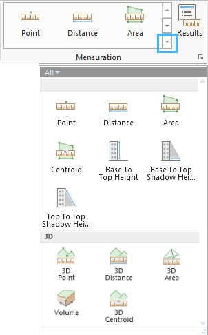

More about image mensuration
The mensuration tools are located on the main Imagery tab in the Mensuration group. Expand the gallery to display all the tools. The type of mensuration tools available depends on the information in the metadata associated with the imagery. Basic measurements can be performed on georeferenced imagery. Measuring the height of a feature requires a sensor model, and measuring feature height based on shadows visible in the imagery requires sun angle information in the associated metadata.
Mensuration tool gallery

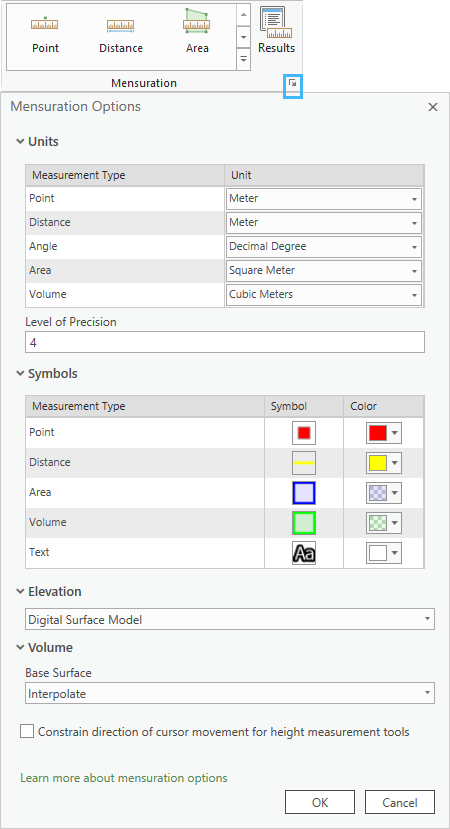

Mensuration options
On the Imagery tab, in the Mensuration group, click the launcher button to open the Mensuration Options pane.
Mensuration Options dialog
The units for Measurement Type can be chosen in the Mensuration Options dialog box. Additionally, symbols and colors for the measurement types can be chosen, and measurement accuracy can be increased by assigning an Elevation dataset using the browse button. Either an elevation file or the URL address of an elevation service can be specified.

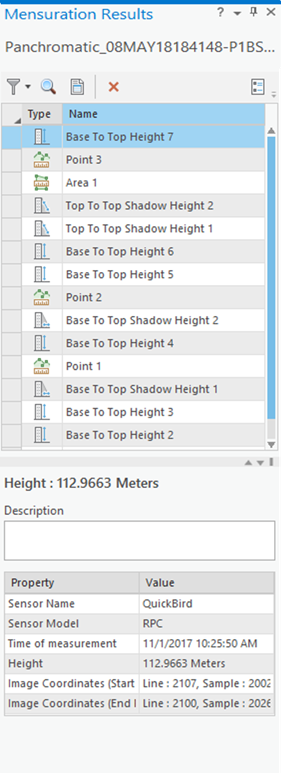

Mensuration Results pane
Measurements can be viewed in the Mensuration Results pane. You can access the pane from the Imagery tab.
The Mensuration Results pane records information about all the measurements for the selected map, such as Type, Name, and Description. When you choose a particular measurement, the result for that measurement is highlighted. Additional metadata about the measurement, such as Sensor Name, Sensor Model, and Time of measurement is also displayed.
You can use the tools at the top of the Mensuration Results pane to zoom to a measurement, delete the selected measurement, open the Mensuration Options pane, and filter measurements based on type.
