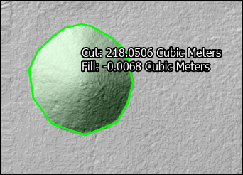

    Cut and fill volume measurements
    The cut and fill volume measurements of an object digitized on a hillshaded elevation surface layer are shown.
    If you use an elevation surface dataset as the backdrop for digitizing objects for volumetric measurement, it is recommended that you render it as a hillshade layer. This will help you distinguish your features of interest in more detail for better digitizing.
