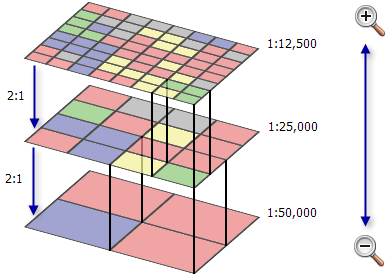

Raster pyramids
Pyramids are used to improve display performance. They are a downsampled version of the original raster dataset and can contain many downsampled layers. Each successive layer of the pyramid is downsampled at a scale of 2:1. The following is an example of two levels of pyramids created for a raster dataset:
Pyramid compression
Pyramids can speed up the display of raster data by retrieving only the data at a specified resolution that is required for the display. With pyramids, a lower-resolution copy of the data displays quickly when drawing the entire dataset. As you zoom in, levels with finer resolutions are drawn and performance is maintained because you're drawing successively smaller areas. The database server automatically selects the most appropriate pyramid level based on your display scale. Without pyramids, the entire dataset must be read from disk and resampled to a smaller size. This is called display resampling and occurs when the display is refreshed.
Pyramids only need to be built once per raster dataset. After that, they are accessed each time the raster dataset is viewed. The larger the raster dataset, the longer it takes to create the set of pyramids, but display is faster and you save time in the long run.
