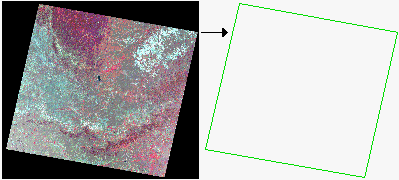

When you need to recalculate the footprint to remove pixel values from a mosaic dataset, you can use the Build Footprints tool. For example, the footprint was originally the entire dimension of the image, but it was since rotated, and you want it to reflect the actual valid pixel values of the images.
