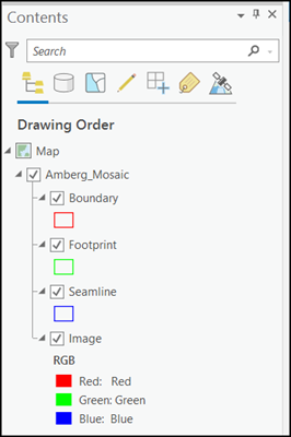

When you add a mosaic dataset to a map, the mosaic layer that appears in the Contents pane is a special group layer with a minimum of three layers by default: Boundary, Footprint, and Image. Optionally, Seamline will be included if it has been generated.
Mosaic dataset expanded view
