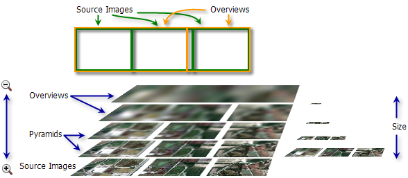

Many source images have internal pyramids, or you can build pyramids. Image pyramids reduce the number of overviews required by the mosaic dataset.
Pyramids and overviews generated for a mosaic dataset
Typically, overviews display faster than pyramids for each raster in the mosaic dataset. Consider building overviews over raster pyramids when using the following types of imagery:
  • Preprocessed tiled imagery, such as orthoimages quadrangles
  • Butt-joined (nonoverlapping) imagery, which will not be affected by changing mosaic methods
  • Imagery processed on the fly, but the parameters and mosaicking method will not be changed
When building more complex mosaic datasets, especially when you use mosaic methods and on-the-fly processing, you can build pyramids on the source rasters and build overviews only when they are needed, such as in the following situations:
  • The mosaic methods will be used due to overlapping imagery.
  • On-the-fly processing will occur on the source rasters at all scales.
  • Images are not static preprocessed rasters.
