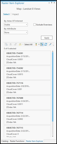

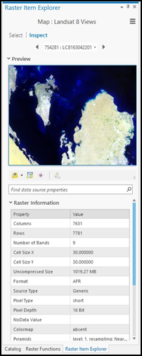

Use the Raster Item Explorer pane
The Raster Item Explorer option can be used to filter items from a large collection of imagery in either a mosaic dataset or an image service and explore the properties of individual items, add them to a map or scene, and view and edit the processing applied to an item.
Raster Item Explorer pane - Select tab
Raster Item Explorer pane - Inspect tab
To learn more, see Raster Item Explorer.

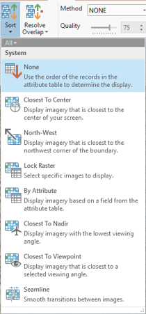

Sort using mosaic methods
Sort methods
Some of the sort methods are well suited to have a collection of imagery be just a collection of imagery. You don't need to perform analysis; you only need to have the imagery in a logical order. In this case, the North-West and None methods are good options. Whenever there is overlap, the North-West method resolves it by selecting the layer closest to the northwest corner of the boundary. The None method orders the images in the same order as the attribute table.
Other sort methods can be used for zooming in and panning around a collection of imagery. For example, when you choose the Closest To Center method , you will be looking at the images closest to the center of the screen. As you zoom in to a feature, the selection updates automatically, so you see the imagery closest to the feature. The Seamline method is used for moving around the imagery. When you put a collection of imagery together, there are a couple of options for identifying seamlines. They can be based on the footprints of the imagery or the features within the imagery. However it is set up, when you choose this option, it generates the seamlines, ranks the images based on the distance to those seamlines, and selects the closet imagery. The result is a smooth transition from one image to the next.
High-resolution imagery may be taken from a viewing angle that is not directly overhead. There are advantages to this and one is that it allows you to measure the heights of buildings based on their shadows, creating a more natural-looking image. You can also see the sides of buildings rather than only the roofs. The drawback is that all of the angles are different, which can be disorienting as you pan from one image to another. Choose the Closest To Nadir method to select the imagery closest to being viewed from directly overhead. Assuming that all of the imagery is oblique, you end up with a less abrupt transition from one scene to the next if you have a lot of tall features, because the viewing angles are fairly close together.
Choose the By Attribute method to use specific attributes to select imagery with minimal cloud cover or that was taken near a certain time. You can then use the Lock Raster method to display only the images you select. These methods have the same effect as using the selection tools of the same names.
If you have imagery over an area using multiple flight paths, you can use the Closest To Viewpoint method . These paths are stored in the metadata, and they allow you to view the imagery from a number of different angles, so you can see the imagery from all sides.
See Mosaicking rules for a mosaic dataset for more information about mosaicking methods.

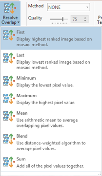

Resolve overlapping pixels
Resolve Overlap
After you've determined the method for ordering, you can fine-tune the results. Use the Resolve Overlap button to access a set of mosaic operators. The First operator ensures that the images at the top of the list is drawn first. Its counterpart is Last, which starts at the bottom of the same list. If you choose Closest To Nadir , all the layers are ranked based on their viewing angle and the layer with a value closest to 0 degrees is returned.
You can also work at the pixel level. There are different averaging and statistical approaches available. The Minimum and Maximum operators take the lowest and highest valued pixel, respectively, of all the overlapping layers. Using this option means that you have no guarantee of looking at the pixels of just one image in the overlapping area but rather a combination of potential layers.
Other options are Blend and Mean, which average the values of the pixels in question. While Mean is the standard averaging technique, Blend works by giving more weight to pixels closer to neighboring images to produce a smoother image. Using either of these operators means that you may not be looking at pixel values from any of the layers.
The last option is the Sum operator, which adds the values of all the overlapping pixels. If you assume that most pixel values are relatively close to one another for each layer, this technique can be useful to visualize where the most layers are.
