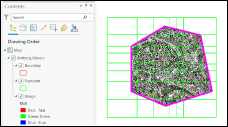

Default boundary shape
The boundary is the full extent of all the magery footprints.

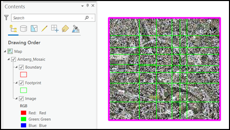

In the example below, the boundary has been edited. The footprints still represent their full extent; however, the mosaicked image is cropped by the extent of the boundary. There is no loss of image data. If you edit this boundary to extend it outward, the image data that you cannot see will appear. This is because you are not editing the source data—only the boundary of the mosaicked image.
Edited boundary shape
The shape of the boundary crops the image data.
