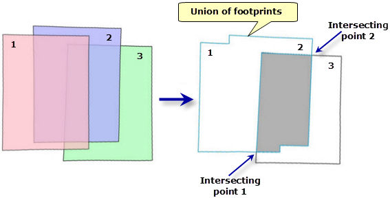

By default, the seamlines are generated using the North-West mosaic method. You can also create the seamlines using the Closest To Viewpoint or By Attribute mosaic method. Based on the method, a ranking value is stored in the SOrder field in the attribute table. When the Seamline mosaic method is used, the SOrder field value is used instead of the ZOrder field value. The SOrder field value determines the order in which the images will be mosaicked together, and—as with the ZOrder field value—the lower value is mosaicked on top. The following example shows the mosaic order of three images and the area of overlap where the seamline will intersect:
Diagram of mosaic order and area of intersection

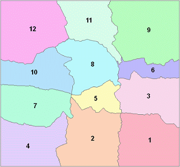

  • RADIOMETRY—Build seamlines by examining the values and patterns in the intersecting area and compute a path between the intersecting points. This path is then merged with the footprint to create the seamline for each single image in the mosaic dataset. The diagram below represents a series of seamlines created for 12 images. The mosaicking order uses the North-West method and the RADIOMETRY computation option.
    Radiometry option
