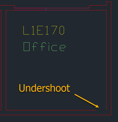

  • Undershoots—This occurs when a line fails to intersect the line it is intended to connect with.For example, if the line representing the southern wall of a room does not intersect the line representing the eastern wall of a room. Endpoints must be within the configured xy tolerance range (default 1mm) to be considered as connected.
    Example of an undershoot in CAD

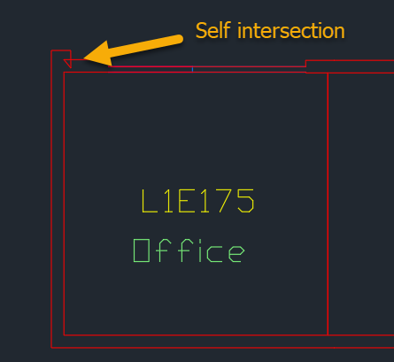

  • Do not include self-intersecting objects—A self-intersecting object occurs when a line crosses itself. If not corrected, this can result in the creation of multiple units or missing units.

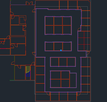

  • Group multiple features for polygons that contain holes—Floor plan data may include features with holes in polygons, such as a hallway that circumnavigates an interior block of cubicles or a central balcony on level 3 that looks out onto level 2. If you are working with AutoCAD, before importing to the Indoors model, group all the closed polylines that make up a feature that includes an interior cutout. If the interior of the polygon is a separate feature, such as a block of cubicles, ensure that the feature is represented by its own dedicated polygon.
    In the following example, the exterior boundaries of the hallway are grouped with the interior boundaries to create a hallway feature with multiple holes cut out of it.
    Grouped closed polylines representing a hallway in CAD.
