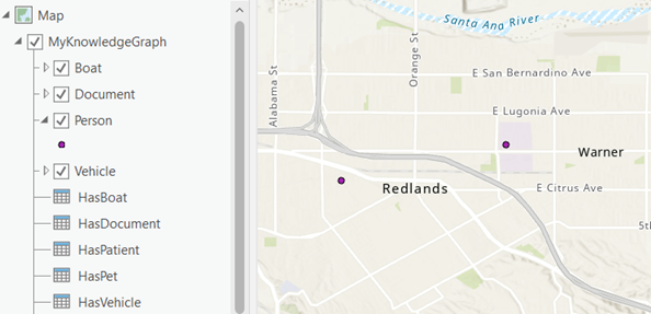

  1. Add a knowledge graph to a map.
    A knowledge graph layer is added to a map. Entities with associated spatial features appear on the map.
    Entities with associated spatial features appear on a map.

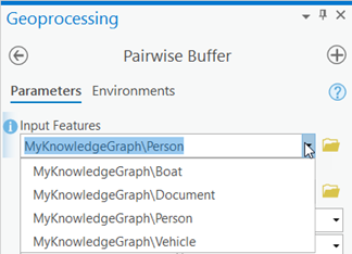

  3. On the Favorites tab, click the Pairwise Buffer tool .
  4. Click the drop-down list for the Input Features parameter.
    The knowledge graph feature layers in the map are available in the drop-down list.
    Knowledge graph feature layers can be analyzed by geoprocessing tools.
  5. Click the entity type whose features you want to analyze with the geoprocessing tool.

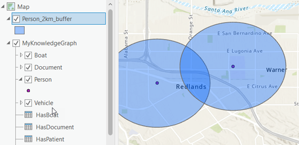

  7. Click Run .
A feature class containing polygons that represent a 2-kilometer area around the entity's spatial features is created in the project's default geodatabase. The resulting feature class is added to the map.
Buffers are created around an entity's spatial features.
