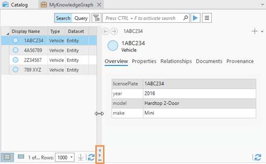

  1. Click an entity type in the Contents pane and click an entity in the contents list to view information about it in the details panel.
    The display expression and entity type are shown at the top of the details panel. For example, if the type of entity represents a person, a display expression might show the person's name. Under the display expression, the Overview tab is selected in the details panel. By default it lists all properties of the selected entity, but it can be customized for each entity type to display a suitable summary.
  2. Resize the investigation view's details panel so you can see both the panel and the contents list by dragging the divider between them.
    You can also use the buttons on the divider to use all the space in the investigation view for either the details panel or the contents list.
    Arrows to resize the details panel

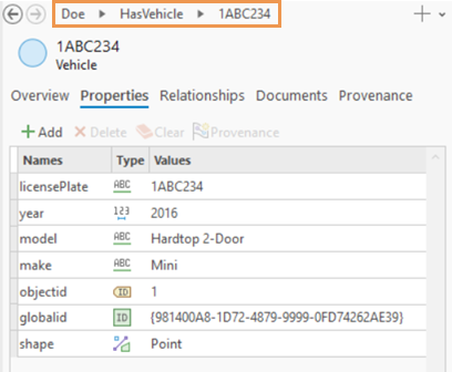

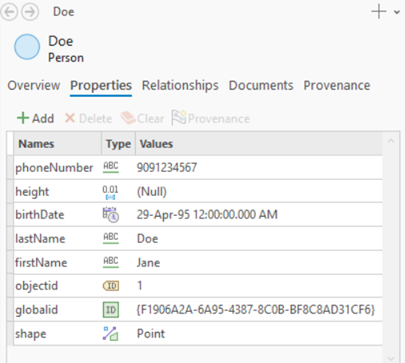

  3. Click the Properties tab in the details panel.
    The Properties tab lists all properties of the selected entity. For example, an entity of type Person might have properties such as first name, last name, birth date, height, and phone number. Property names appear in the Names column, the data type of the property appears in the Type column, and property values appear in the Values column. If the person's height is unknown and therefore a value has not been set for this property, the text <Null> appears in the Values column.
    An entity's properties in the details panel in the investigation

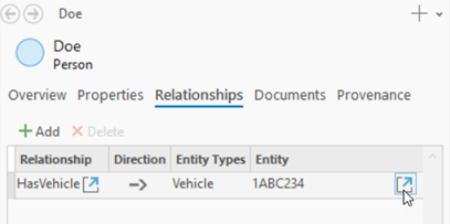

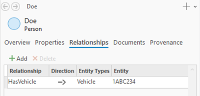

  4. Click the Relationships tab in the details panel.
    All relationships defined between the selected item and other entities in the knowledge graph are listed. Each relationship's type appears in the Relationship column. The direction of the relationship appears in the Direction column. The entity with which the selected item is associated is shown in the Entity column.
    For example, if the selected entity has the type Person, it might have a relationship such as HasVehicle. The direction would be forward from the person to the car, and an expression identifying the car entity would appear in the Entity column.
    An entity's relationships in the details panel in the investigation
    Similarly, if the selected entity has the type Vehicle, it might have multiple HasVehicle relationships listed in various rows where each row identifies a co-owner of the car. The direction would be backward from the person to the car, and an expression identifying each Person entity would appear in the Entity column for the appropriate row.

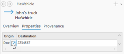

  5. To get more information about a relationship or a related entity, hover over the relationship in the Relationship column or the entity in the Entity column.
    An Open button appears.
    The Open button for the relationship or a related entity
  6. Click the Open button for the relationship or related entity.
    Details for the relationship or related entity appear in the details panel. The location bar updates at the top of the panel to indicate how you got there. For example, if you started with a Person entity, and you opened the related Vehicle entity to get more information about the car, the location bar shows the display name for the original entity, the relationship that was traversed, and the display name for the related entity.
    The location bar indicates how you arrived at the current entity or relationship.
  7. Click an entry in the location bar at the top of the details panel to see details for a relationship that was traversed or a related entity.
    In the above example, you would click the HasVehicle relationship to see the relationship's details.
    Properties of the entity or relationship are displayed in the details panel. The location bar is updated to show where you currently are with respect to the selected item in the investigation's contents list.
    The location bar shows the current entity or relationship and others previously explored.

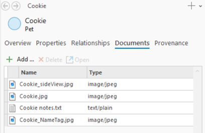

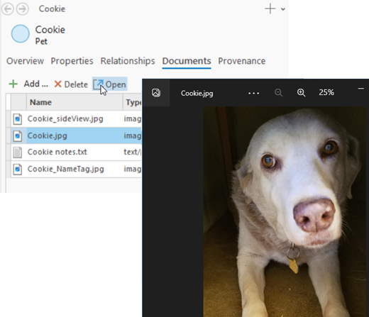

  9. Click the Documents tab in the details panel.
    All documents associated with the currently selected entity are listed. Each document's file name appears in the Name column, and the document's type appears in the Type column.
    Documents associated with the current entity are listed on the Documents tab.
  10. Click a row for one of the documents in the list to select it.
  11. Click the Open button at the top of the list to open the document and view its contents.
    The document opens in a suitable application as determined by the Windows operating system.
    The document associated with the entity opens using an appropriate application.

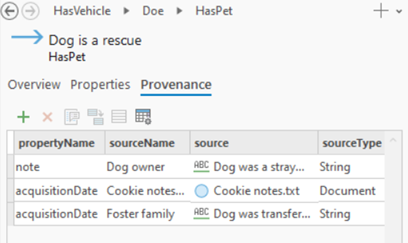

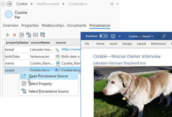

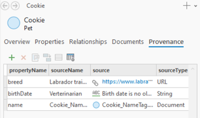

  12. In the investigation's details panel, click the Provenance tab.
    All provenance records associated with the currently selected entity are listed. You can see the properties of each provenance record in this list.
    Provenance records associated with the current entity are listed on the Provenance tab.
  13. Right-click a provenance record and click Open Provenance Source .
    The website or file that is the source of information stored in one of the entity's properties opens in a suitable application.
    The source identified by the provenance record opens using an appropriate application.

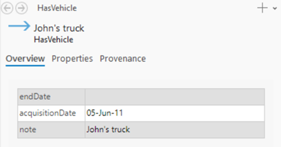

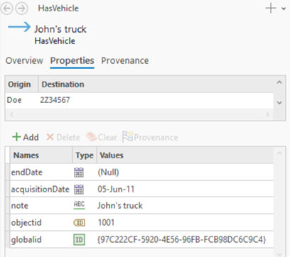

  2. Click the Properties tab in the details panel.
    The definition of this relationship appears in the table at the top. The entity from which the relationship originates is identified in the Origin column, and the entity that is the target of the relationship is identified in the Destination column. For example, a relationship of type HasVehicle might be defined with the origin as a Person entity to the destination as a Vehicle entity.
    Properties of this relationship are listed in the table at the bottom. For example, a HasVehicle relationship might have properties such as acquisition date, end date, and notes. Property names appear in the Names column. The data type of the value appears in the Type column. Property values appear in the Values column. If a property's value is unknown and therefore a value has not been set, <Null> appears in the Values column.
    A relationship's properties in the details panel in the investigation

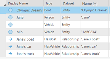

If many entities or relationships of the same type are selected in the investigation, the details panel shows all property values that they share. However, the details panel only shows properties that are common to all selected entities and relationships in the investigation. If the selected entities or relationships have different types, the objectid and globalid may be the only properties shared by the types.
The details panel shows properties common to all selected items.
It can be more productive to compare property values directly in the investigation's contents list for many entities and relationships at the same time. Display columns allow you to view and contrast property values for all items in the contents list. Different types can have different names for the same property—you can show these values in the same column.

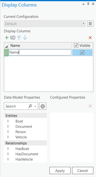

To add a display column, complete the following steps:
  1. On the Investigation tab on the ribbon, in the Display Columns group, click Display Columns .
    The Display Columns pane appears.
  2. Click the Add Display Column button .
    A row is added to the Display Columns list, and the default name for the new column is immediately editable.
  3. Type a name for the display column and press the Enter key.
    For example, type Name.
    Name for a new display column

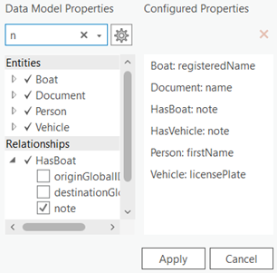

  4. Under the Data Model Properties heading, click the expander for entity types and relationship types to list their properties.
  5. When there are many types and each type has many properties, filter the list of entities and relationships to find the property you are looking for. Under the Data Model Properties heading, click in the Search text box and start typing the name of the property you want to find.
    You can search for a property by name.
  6. For each entity type and relationship type, check the property whose values will appear in the display column for all types to which the display column should apply.
    For example, if the knowledge graph had entity types for Boats, Automobiles, and Motorcycles and all have a Model property, check the property for all entity types to show the Model value in the same display column. The selected properties can have different names.
    Properties that participate in the display column can have different names.
  7. Click Apply.
The new display column appears in the contents list. Entities of the appropriate types will show the selected property values in the display column. For example, if boat and automobile entities appear in the contents list, the Model display column will show values for each boat and automobile with this property.
A display column shows values for different properties for each type.

Customize the Provenance tab
A provenance record can have many properties. You can configure which columns appear on the Provenance tab to see only the properties you need and change property column order. You can save the provenance property configuration for all investigations that share the knowledge graph service.
  1. In the Contents pane, on the Investigation tab, select an entity or relationship type.
  2. In the details panel, click the Provenance tab.
  3. Click the Configure properties button Configure properties
    The Configure properties dialog box appears.
  4. On the Configure properties dialog box, check the provenance record properties you want to see and uncheck the properties you want to hide.
  5. To change the order in which the properties appear, click a property and click the arrow buttons on the side of the Configure properties dialog box to move the property up or down in the list. Optionally, click a property and drag it to a different position in the list.
  6. Click OK.
    Only properties that were checked on the Configure properties dialog box appear in the list.
  7. On the Investigation tab, in the Manage group, click Save Default Properties to save the provenance properties layout to the knowledge graph service.
  8. Optionally, on the Investigation tab, in the Manage group, click Manage Default Properties to delete the provenance properties layout from the knowledge graph service.
